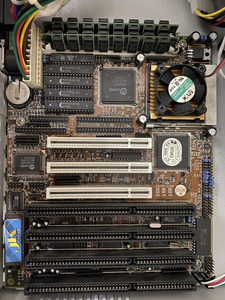

This is my 486 PCI board that I got from university laboratory in late 1990’s. At that time laboratory people changed their PC to new one and I got one free from them.

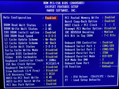

Thesedays I’m trying to re-new my old PC’s and just started looking around this one to set another 486 PC. Today I found that I almost forgot everything about this board and I don’t have much information about this mainboard. For example, after spending some time I found that with EDO ram I should precisely set ram type as EDO otherwise CF card cannot be read properly showing error message in spite of being recognized well and success to boot up to stage of reading it.
Anyway I‘m willing to setup a AMD 5x86 160MHz system and want to confirm some information.
- CPU :
I have two AMD 5x86 and both are upgrade modules. One is Evergreen 5x86 upgrade module with heat sync and the other is PNY qucik chip 586. I should have to set voltage at 5V to use these but I can only see jumpers for setup 3.3V , 3.45V, 3.6V and 4.0V. Are there some late 486 boards do not support 5V and maybe I cannot use these upgrade module on this mainboard? If someone has manual of this mainboard please share it to me. And also I wonder these CPU upgrade modules are also capable of OC to 160MHz.
- FSB/PCI setup :
I can see only 25, 33 and 40MHz jumpers and PCI divider is 1:1 and 1:1/2 only. If I set 40MHz FSB, PCI also operate at 40MHz with 1:1 setup and ISA will be 10MHz. Are these setup are OK in terms of hardware stability?

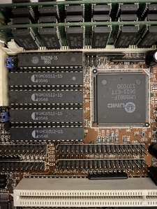

- Cache memory :
It seems 4 GMC6512-15 and one TK62256-15 are L2 caches. Are these ok at 40MHz or should I change them to 12ns or 10ns ones?
- Ram :
EDO or FPM? If there is EDO 50ns and FPM 60ns which is better?
- Mouse :
There is no PS/2 mouse port so it seems serial mouse should be used. But serial mouse is too old and not convenient to use. Are there any other options?
- PCI/ISA board :
There are 3 PCI and 4 ISA slots but one PCI and one ISA slot bracket is overlapped at the middle. Therefore it seems 2 PCI/4 ISA or 3 PCI /3 ISA is max. installable. Are there anyone who use all of these 7 slots and if then how?
Please see attached mainboard picture. And if someone knows detailed information about it - manufacturer, model, last BIOS to update and so on, please let me know. If possible, I want to find the manual of this mainboard.

Reply 1 of 12, by Anonymous Coward
I once had one of these boards, but it was dead and I couldn't get it working. I am pretty sure the manufacturer's name was Sunnyvale Labs, but I can't seem to find any information on it. PCchips M921 looks identical, so it was most likely a case of badge engineering.

Reply 3 of 12, by PC Hoarder Patrol
Anonymous Coward wrote on 2020-03-28, 04:47:
Thinking of the SYL8884? - this thread mentions it (with links) and the ST1A REV B
TD-4IP-UMC-AIO PCI Socket 3 Motherboard
Reply 4 of 12, by ychh0
PC Hoarder Patrol wrote on 2020-03-28, 05:14:
It seems my board is very close to the one or may be the same. I happened to remember that in the late 1990’s SOYO 486 PCI board was very popular in Korea and I heard that mine is also made by SOYO. It could be.
I nearly figure out how to set jumpers except for CPU type part. I don’t understand how to to set up 1-2, 3-4 and so on. It’s like a puzzle to me.

Reply 8 of 12, by ychh0
It seems I can get max. 512kB L2 cache according to information found in PC Hoarder Patrol shared link.
It says L2 cache was upgraded to 512kB using 4 UMC UN611014BU-15. Current cache memory installed on my board is 4 GMC6512-15 and 1 TK62256-15. Should I change TK62256 and to which?
Reply 9 of 12, by RacoonRider
No, TK62256 is TAG RAM, you do not need to change that. For 512K cache with your board, you'd have to use 4 1024k cache chips. Rare, expensive, and does not change pretty much anything in terms of performance for a 486.
It's only needed to make RAM over 32 MB (WB) or 64 MB (WT) cacheable and let's be honest, 32MB is already overkill for a 486. That's true for my chipset (SIS 496/497), it might be different for UMC.
