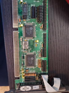

Thanks for your response. I have attached a picture of the card. I also was surprised that the Tyan card only has one IDE connector. I have the port set to 170 on the second card. It doesn't have an option to set the IRQ. I found a page with the jumper settings at:
https://stason.org/TULARC/pc/hard-disk-floppy … IODE-3292U.html
I have everything on the card set to disabled except the IDE. I think my bios supports 4 hard drives. When I do autodetect drives in my bios it has spots for primary master and slave and secondary master and slave. I am using only DOS 6.22 for now. I plan on installing Windows 3.11 eventually. Thanks again!

Hmm, That's not a picture of the card, with the actual jumper setting, or is it?
All Jumpers seem to be in 2-3 or 1-2? That is not correct. 😁
EDIT: Your photo shows that all jumpers are in position 1-2, I am about 90% sure.
Can you make a picture of the card with the actual setting?

it's very likely that he just found a stock photo of his card online rather than bothering to stage a photo shoot of his own
I doubt the OP is braindead enough to not understand jumper settings
Reply 7 of 20, by Brutus814
Sorry, that is actually a picture I took of the board before I started messing around with jumpers and putting it into my computer. It was easy to access on my phone. I am not at the computer right now, but I will take it out when I get home and take a picture of it as it currently is. I can tell you from my notes that I have JP2-JP6 with pins 2&3 closed, JP 7 with pins 1&2 closed, JP9-JP11 jumper removed (since these are disabled), JP 12 has pins 2&3 closed and JP16-JP17 are removed also.
After I sent my last post, I did make some progress. I moved the CD-ROM jumper to the master position. I then went to the bios setup and did the IDE HDD autodetect. It will correctly detect the HDD as primary IDE master and the CF as primary IDE slave. I usually just skipped the secondary IDE master/slave since there is no HDD on those. This time, however, I let the bios try and autodetect the secondary master. It came back with a listing of zeros in all the slots and I typed Y to accept and then skipped the secondary IDE slave. I restart and it correctly identifies the CD-ROM and boots to the DOS prompt without problems. I can access the HDD, all of the CF drives and the CD-ROM. When I CTRL-ALT-DEL and reboot, it will load without problems. Then, if I reset the computer or turn it off and back on, it will run through the memory test then it will stop. It will say press DEL to enter BIOS setup at the bottom of the screen. If I enter the BIOS and go through the process listed above (let the BIOS try and autodetect the secondary IDE master) it will then reboot to the DOS prompt. If I let it sit long enough on the screen after the memory test, it will eventually say "Hard Disk(s) Fail (10)." Any ideas?
Thanks!

OK, the jumper settings are correct. I would not remove any jumpers, so better put back 9,10,11,16,17 to default 1-2.
But I don't think that's a problem, but who knows.
As already mentioned, for the CD ROM do not use auto-detect, just use "None".

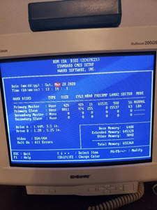

I will replace the jumpers. I have tried a few different things and it seems that for some reason, the computer can not correctly identify the HDD and CF when it starts up. If I go into the BIOS and look, it lists the HDD and CF card correctly (see picture), however, it will only boot up correctly if I autodetect the drives, save settings and reboot. I replaced the CMOS battery yesterday with a fresh one.

Can't you set primary master and primary slave to "auto" instead of type "USER"?
When that is supported by BIOS it would autodetect it on every boot.
Reply 13 of 20, by Brutus814
Unfortunately it doesn't give me an option for an "auto." My only options for TYPE are 1-45, USER and NONE. The USER settings are what it found with autodetect. When I do autodetect again, it doesn't change anything because it was already set. That's why it is confusing to me because it is already in there as a USER setting.
Reply 14 of 20, by CoffeeOne
Brutus814 wrote on 2020-03-28, 18:52:
Is there an "AUTO" for mode, or only NORMAL, LARGE and LBA?

Maxtherabbit, after autodetect, it shows the correct settings in the IDE setup part but after a reset, the system can not correctly identify the drives unless I go back in to BIOS and redo the autodetect, even though it still shows the same, correct settings on the screenshot I posted above without doing the autodetect.

I have one more thing to try out....
Maybe it is just a timing issue. Try out the following: Boot up the machine, go to BIOS. Do not change anything (as you said the parameters for the drives are already correct). Wait one minute, then save and exit.
Does it work now, too?
