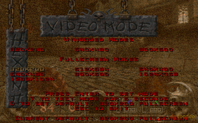

I've been trying to get the software version Hexen II working but it has this rainbow effect (seen below)
file.php?mode=view&id=80598
My guess is that it has something to do with the color depth and DirectDraw. I assumed that dgVoodoo would be enough to remedy the issue, but it seems like this isn't the case. It didn't even add back the legacy non-square pixel resolutions (320x200, 640x400, etc). I tried fiddling with DxWrapper to no luck. I know that the issue fixes itself in Windowed mode, but windowed resolutions are limited, and I'd like to have all the original resolutions at my disposal.

Reply 1 of 18, by ZellSF
Works fine here. Can't even figure out a way to break it.
Is ddraw.dll in the same directory as h2.exe? Are you sure it's loaded (do you get the dgVoodoo watermark)?

Yeah the watermark doesn't even show up when I tried it. And yes, I do have the ddraw.dll file in the same directory as h2.exe.

That seems to have fixed the color issue, thanks a bunch. Now I'm curious as to how I can also get those legacy resolutions working.

Later versions seemingly don't use ddraw by default. Just add -usedirectdraw to the commandline and it will work fine.

But anyway, the commandline thing worked!! My legacy resolutions working with dgVoodoo, thanks a bunch! ^^
