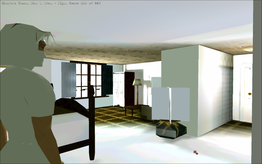

Hello, I've encountered a problem with current version 2.63.1 on Gabriel Knight 3. As I'm using the gog release I found help there and it appeared that only versions up to 2.55.4.1 work correctly. From 2.6 it displays like this.
Using older version fixed my problem but I thought I might post here because maybe something can be done to fix current versions.
My setup is Win10 x64, ryzen 7 3700X, radeon RX 5700 XT.

Yes, it's a known issue with dgVoodoo+AMD cards (GCN2+).
Could you plz try the dlls (DDraw/D3D7 only) from the experimental build I made a few days ago (and updated just now)?
I've just given it a go with GK3 and worked.

It does work indeed, will this be implemented in the future release ?

Yes, that's my plan. But it isn't ready yet, it's in rather early stage.

Well thank you for the files, I'll use them for now, or maybe is it safer to revert to v2.55.4.1 ?
Reply 5 of 6, by Dege
If you worry about game crashes with unsaved progress then it's safer to revert to the old version. I didn't do extensive testings with the experimental build.
