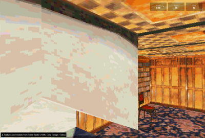

Reply 1 of 9, by xjas
Cool engine! Looks better than the stock Tomb Raider rendering. Would love to see this get used in some things.

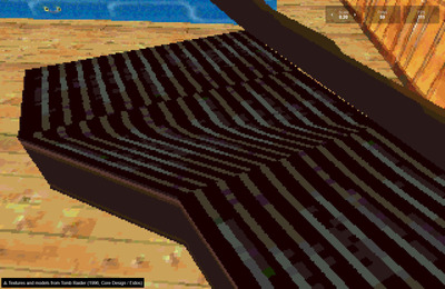

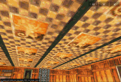

Nice implimentation of affine texturing. 😀
Reply 2 of 9, by vvbee
xjas wrote on 2020-04-25, 07:04:
It's actually perspective corrected, don't know why that particular detail looks like that both in-game and in the renderer.
But you can turn off perspective correction to get pure affine as well. The game lets you do it too, and since it uses quads (or n-sided polys anyway), the effect looks a bit different than what you get with triangles.
Reply 3 of 9, by xjas
Hmm, in the Tomb Raider demo it looks like "square"/rectangular quads get rendered perspective-correctly at any angle, whereas deformed quads (at least one pair of non-parallel sides) show PS1-style warping? Does that make sense?

Reply 4 of 9, by vvbee
Depends on what you're after. The goal of this renderer is the opposite of rendering without errors or inconsistencies - so long as the output looks like it's held together with tape, it's doing its thing in true 90s fashion. Only those render issues that get too glaringly in the way are a problem.
It's been nearly a year since I implemented the Tomb Raider scene for this, so I can't remember the specifics, but since the software 3D engines of that era were all doing their own thing, you're probably not going to end up with a general purpose renderer that also faithfully replicates other engines without specific render paths. But rendering scenes meant for a variety of other engines is a good way to stress test yours.
I think in the Tomb Raider demo you can press F4 or F5 to toggle the perspective correction modes.
