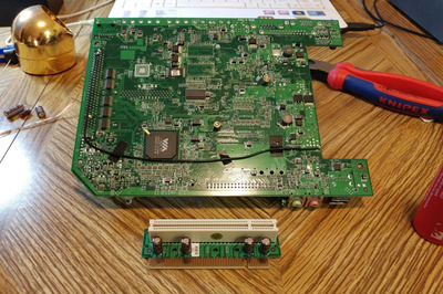

I ended up doing the 5V mod... As you mentioned, the Fujitsu motherboard is slightly different & mine doesn't even have D18 in that area on the motherboard.
465.97 KiB
4263 views

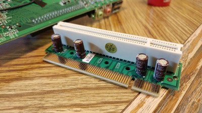

I also added a few filter caps to the PCI riser. I just guessed at the values, and didn't bother with the tiny surface-mount ones, but I figured it couldn't hurt. Not sure these make that much of a difference.
204.05 KiB
4263 views

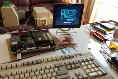

At first I tried the worst ESS SOLO-1 I've ever seen. I could actually hear output from this without the 5V mod, but it was at the same level as the noise floor & if you cranked up your speakers you could just about make out what was going on, albeit while wincing in severe ear-pain. It also output a persistent whine from bus noise. With the mod done (including the filter caps), it... wasn't any different to be honest, just louder. Don't buy these! 😜
Then I tried a CMI8738 that previously wouldn't even initialize. Worked great!
244.48 KiB
4263 views
(Don't mind my Apple II on the couch in the background, it's not supposed to be there. Long story...)
This thing actually sounds really good - the output is decently clean, and the FM isn't bad at all. Digital sound doesn't work in some games & demos, but that's to be expected with these. I'll probably try a few more cards later (my Ensoniq / Creative CT4810 would probably work now), but for now I'm just happy to have this little box on my desk with decent sound support.

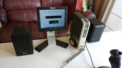

^^ Nice! I've been a little disappointed in the CMI8738 - the FM sounds pretty good, but it seems there's very little compatibility for PCM playback. Only a select few titles can do anything with it. Still, if you consider it an "Adlib"-type FM card (actually OPL3) it does the job pretty well.
I tidied up my table a bit & here it is filling the room with FM synth tunes through a pair of Minimus 7s (using an old boom box under the table as an amp) :
133.36 KiB
4195 views
Is there a good list of stuff to try that's known to work with the CMI8738 somewhere?

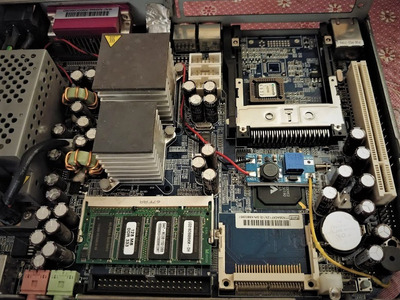

Here it is the final mod with +12V this time, thanks to this small pcb i did buy on internet for around $2 :
Believe me, the thing is small, i have small fingers 😉
You just have to solder the Vin- pin to the common mass of the machine, and the Vin+ pin to the 5V delivered by the internal power supply.
Next, move a little bit the littre screw on the blue component on one side, until you reach around +12V, and voila !
Next, of course, solder the PCI pin cable to Vout+ and here you are.
I did use what we did before with the +5V mod and the wire already soldered to the voltage missing PCI pin :
Next, on the up side, i glued the module like this so it is okay to check and nothing gets in contact with it :
A zoom on the small beast :
Another view around :
