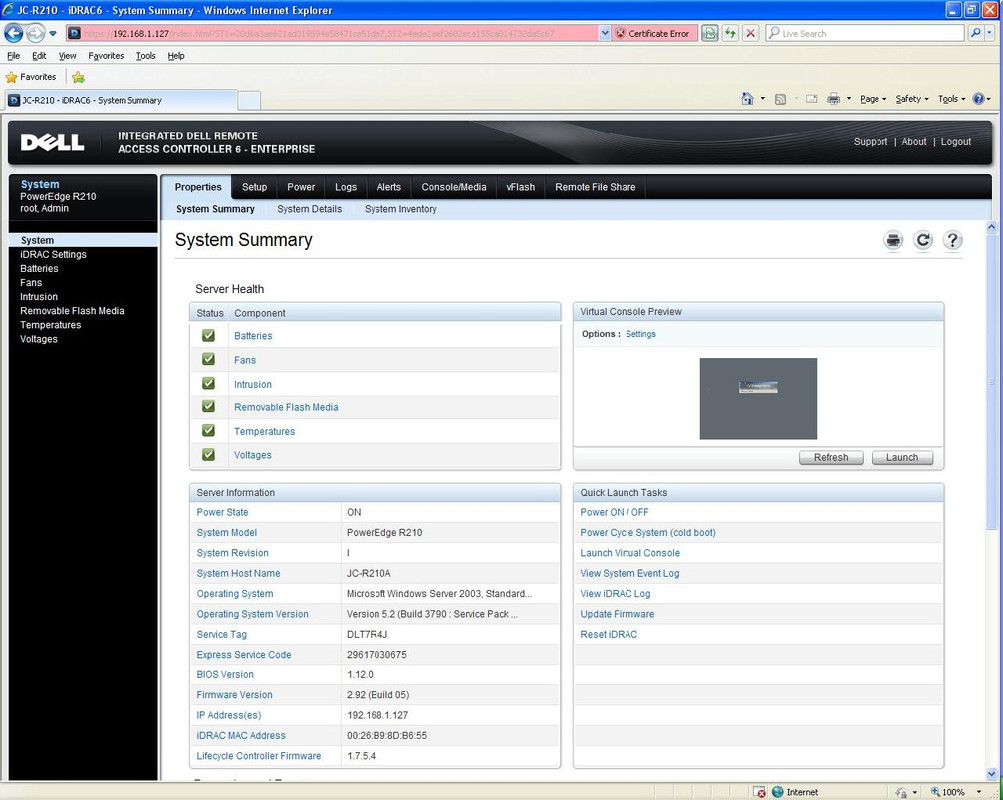

and best of all it has iDrac Enterprise.
The basic version allows you to remotely power on/off via a web browser but Enterprise also allows you to connect iso and disk images as a virtual drive and boot off them 😀
It also lets you remote onto the desktop although your best off sticking with 32bit version of IE for this.
Hardware wise I've done little to it as it is only short term for now. It actually shipped with 2x 2GB sticks of ram but I've a number of similar T5500's and R710's with RAM and CPU's been canablised and swapped around as needed. This wont need 4GB for what I'm using it for but like the idea of maxing out Win03.
Drac has been updated to 2.92 Build 5 and BIOS to 1.12.0 both freely available on Dells site (unlike other server brands...HP!) everything else was upto date already.
