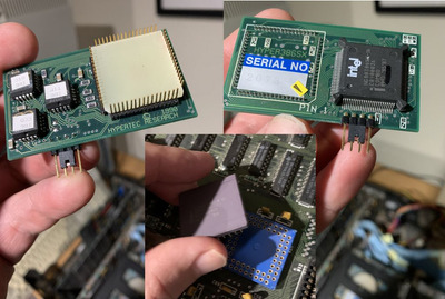

I have this Hypertec 386sx-16 upgrade cpu and I finally decided to try it in my IBM 5170. The problem is when I pulled out the 286 cpu (with much, much effort!) the pins on the upgrade board don't match the pins on the socket. I read on this forum that this upgrade could slot right into the 286 socket, but it doesn't appear to be the case. Anyone have any experience with these? It almost seems like I'm missing an intermediate board between the two. Also, my 286 board is 6mhz. I'm assuming since this 386 is 16mhz, that it's probably for a 8mhz 286.
But I'd also think that with a system as popular as the 5170, this upgrade should be compatible somehow?
...anyway, I just looked up Google images of this upgrade board and the images there have the correct pins. Only mine is different. 😒
It must be for another type of 286 socket?

That upgrade module appears to be designed for a PLCC chip socket, as the vast majority of 286s were. The 5170 and 5162 used PGA sockets. Unless you make a homebrew adapter, it's not compatible
Reply 4 of 21, by keropi
indeed! but what you can do it buy a 68pin PLCC socket, insert it in the blue motherboard socket and then install the upgrade on top

That's not going to work. While it seems so, the pins are not connected the same way due to the way a PLCC socket has to route one row of pins to two rows in order. You would fry the whole thing.

I don't see why it wouldn't work. That's how I use 386 upgrades on my 286 board. The real issue is that the pins on the PLCC socket are flat not round, so it's not as secure as I'd like. Ideally you should remove the PGA socket and solder the PLCC socket directly to the motherboard.

You need an adapter for this. You can not replace a PGA socket with a PLCC socket by just replacing it. Their pin-out does not match. Google for "replace pga with plcc socket" if you don't believe it - there are even companies specialized in making such adapters.

I will get a PLCC68 socket in a couple of hours and will report back if this will work or not
edit: the pins round/flat are not such a big issue - I have modified a damaged 286->386sx upgrade and I used a PLCC68 socket : it fits perfect (and actually quite tight) in round pins and never caused any issues in the ~2 years I am using this

Allright the results are in:
Putting a PLCC socket in the PGA socket will work just fine assuming you align the sockets correctly as seen by the PIN1 designation in the pinouts.
The lines I have drawn are the connections between I have measured and all checks out as it should be:

Yeah, intel CPUs PGA and PLCC socket pinouts match.

Thanks keropi, you've spared me some minutes. So it's nothing to "rearrange", the pinouts are already 1:1, just the form factor differs.
exactly, just match "pin1" and you are good to go
