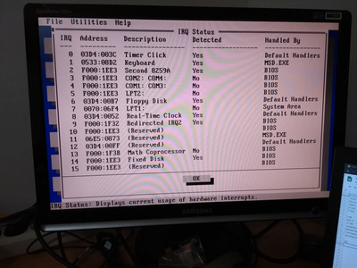

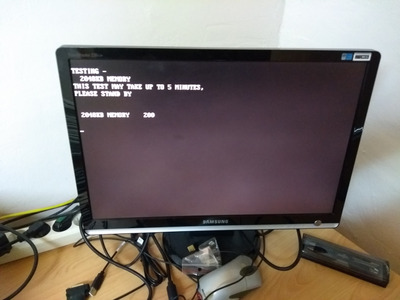

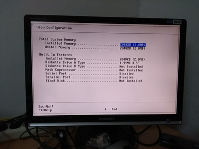

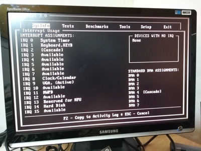

Maybe it could be some Memory problems but i’m not sure. I tested memory with Checkit (i add a picture) and strange problem, memory test passed, an das u see, it writes „Press any key to continue“ but it hangs up and now restart is working. I need to turn computer off.
I thougt maybe ist memory problem and i used advanced diagnostic disk from IBM and made a lot of memory tests and they passed fine (i add picture too). So no memory problem? Message 200 means no error.

So, now i solved 2 of 3 problems.
1: Checkit crash after memory test: It seems like its not working when you set DOS=HIGH, UMB in config.sys, if you remove this, checkit work very well.
2. FTP Problem: its working after set config file:
