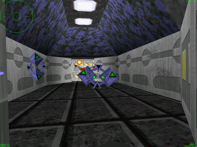

^^ D1X 1.43 OGL running with the "radar" (shift-F3) - haven't seen that in a while! I remember trying really hard to get some advantage out of that radar in net games, but it just wasn't very useful in practice. 😜
