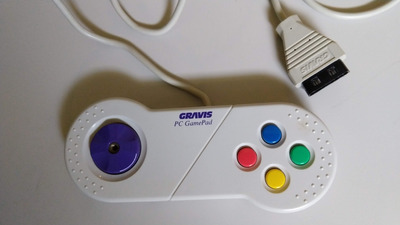

The only part I purchased was the gamepad for $8 USD shipped from eBay, as I never had a DOS gamepad before. I liked the Deskpro because it was a P3 in a pretty small form factor and hoped it would make a powerful DOS workstation. I knew I would face some incompatibilities from using a P3 PCI system for DOS, but was surprised at how much worse it was than I imagined.
The best part of this retro DOS PC was playing games. With the use of throttle.exe and the gamepad, I enjoyed the tactile and low-latency retro DOS gaming experience, with pictures much crisper than what I got from DOSBox.

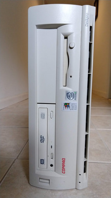

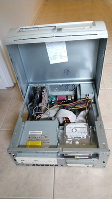

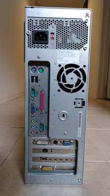

Reply 1 of 103, by enaiel
I guess some pics are in order:
