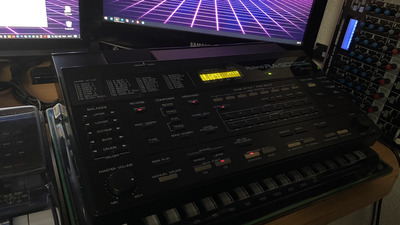

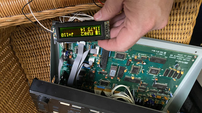

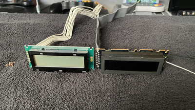

I recently bought one, and as far as i am aware it does not have the extra sound effects that the CM-32L has. it is 'just' an second generation MT-32 in that respect, but A LOT cheaper 😀
Don't like the display that much though... too 'generic'.. 😀
I have a spare green LCD laying around that originates from a Roland D-10 and I am going to try to see if I can get that working in the RA-50, should be looking nice.

Success 😀
