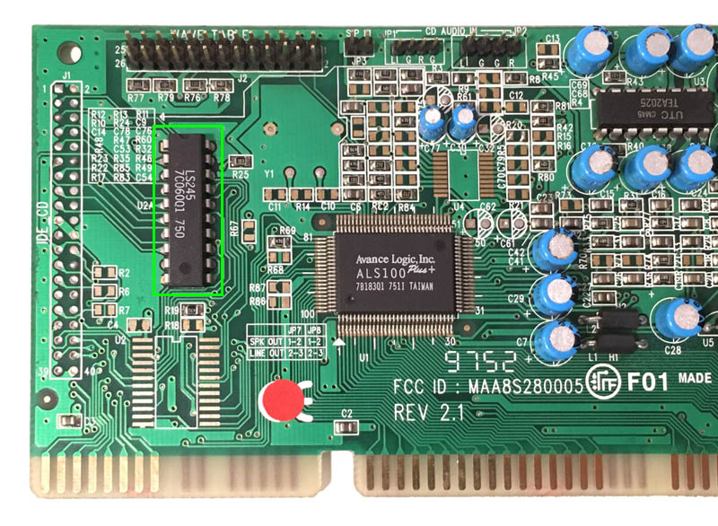

Hi,
First of all, this is a long post, including photos, pinouts, oscilloscope measurements, facts and explanations. So if you are interested, take some time to read it 😀
Why I titled this post "All the truth about FM in ALS100 Plus+ cards?
After about 25 years of confusing info, opinions of all flavours and so, I couldn't understand some things about these ALS100 Plus+ cards... the weird DIP20 chips often present in some variants WITHOUT IDE header, the SOP24 chip footprints (for YAMAHA OPL3 chips or clones like LS262, FT6116, LS-212...) with almost all pins matching the DIP20 footprint near or over it, some cards having 2 DIP20 LS245 chips... (for what???)... also the fact that EVERY ALS100+ card has, at least, one of these: 1) a DIP20 "LS245" or "RTA1000" chip, or 2) a SOP24 known OPL3 clone like the ones mentioned earlier.
And the fact that (even though some people deny it) FM sound in ALS100+ cards is very good (sounds like the authentic Yamaha chip). Yes, I know the bad quality of the cheap cards, with bad quality caps, bad quality amp ICs, filterig, etc, make the sound to be worse, even very bad in some cases, but anyway, FM sounds OK...
Well, finally I decided to uncover all the truth about all of this, and made a lot of tests, unsoldered and soldered chips, made measurements... and, altough it may seem unusual, I'll start with the main conclusions, and then the tests and explanations:
Conclusions:
____________
  1. The "LS245" and "RTA1000" DIP20 chips ARE in fact Yamaha OPL3 clones. This is a FACT, and it's proven. More on this later. The LS245 analyzed here is NOT a regular known 74LS245 "octal bus transceiver". (Well, if the board has 2 or more of these, and doesn't have a SOP24 IC, then one of the LS245 is fake 😉)
  2. The ALS100 Plus+ chips DO NOT HAVE an internal FM implementation. Avance Logic CHEATED on the documentation.
  3. These clone chips, don't carry the "SMPAC" signal needed for the YAC512 2nd channel to output stereo (ALS100+ chip does this job)
  4. The final conclusion is, the ALS100 Plus+ chip should be called "ALS100 Minus-" chip, because it's the same as the ALS100 but without high DMA selection, only 0, 1 and 3 are available for HDMA. Anyway it's capable of doing 16-bit audio with low DMAs using techniques like the Creative ViBRA16XV does, so it's still a good card.

Good, let's start with the first clues about the 1st point.
Let's see one of my ALS100+ cards (untouched):
See the "LS245" labeled chip? Okay, let's remove it:

Reply 1 of 40, by mkarcher
Great analysis!
JazeFox wrote on 2020-06-20, 08:51:
[*] The ALS100 Plus+ chips DO NOT HAVE an internal FM implementation. Avance Logic CHEATED on the documentation.
Okay, now, as shown in ALS100+/ALS200 documentation, this chip has internal FM emulation (nope, cheaters!!). To enable it, without external OPL3 chip mounted, ALS100+ pin 58 (/FMCS signal) must be connected to GND via 10K pulldown resistor. In my card it's R67. I did not take a photo with the resistor mounted, but i mounted it and tested. Check R67 location in previous photos.
Tried the card without chip and with R67 10K resistor (supposedly to enable internal FM sound). Ooooops!! No FM sound!! Suspicious...
Maybe ALS (intentionally?) used ambigous terms here. "FM emulation" might just mean that the ALS100+ chips fakes the presence of an OPL3 chip to software (by implementing a fake status register and the the two timers), so that software that probes for an OPL2/OPL3 detects its presence, although it does not produce any sound. Did you try whether pulling down /FMCS on your card makes software detect an OPL3 chip?

Reply 13 of 40, by appiah4
Wow, so interesting. So the LS245 on this card is also not an IDE bus transceiver but an YMF clone? (In hindsight, why would it be? This card has no IDE headers!)
That's interesting. But I should have known! It's connected to the same pins as the ones that the LS262 YMF clone is connected to on this ALS007 card!
I dug through my ISA pile and see if I have any other LS245s on any other cards, but no - only ALS100+ cards have these. I turned down an offer for about a dozen of these a month ago for like a buck a piece.. *FACEPALM*
Also for reference, a real LS245 bus transceiver on an OPTi931 card that sounds nothing like real OPL3:
