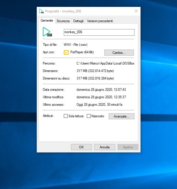

Hi Guys
I captured audio with Roland MT-32 by DosBox
I dont know why the track in .WAV cannot be reproduced..it's a silent track
Reply 1 of 10, by Qbix
Rank DOSBox Author
DOSBox Author
if you use midi in dosbox. you can't capture it with the dosbox capture, but you have to use audacity or something like that.
(as the midi sound isn't generated by dosbox)

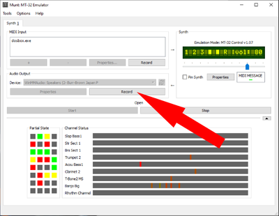

Hmm, munt may have, I'm almost sure it has, a way to output as file. Grab the full Munt, not just the driver for that and look around in the settings.
Alternatively, do as Qbix suggested, and record the audio via Audacity or anything else.

Reply 9 of 10, by konc
@Mark_81: I believe you are confused about something here, which I'll try to explain:
As Qbix wrote, Dosbox delegates playback of midi to the host system, eg Windows. So when you play midi, Dosbox is not playing any music. That's why your recording is empty.
Which means you should record it from windows, not dosbox.
Dominus' advice is valid, munt has an obvious "record" functionality, have you seen it? If you only want to record midi music, this is all you need

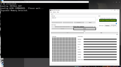

Reply 10 of 10, by ShirBlackspots
Lets try this
198.01 KiB
441 views
59.85 KiB
441 views
And the output will sound like this: https://www.dropbox.com/s/dooevp70ibl1neu/test.wav?dl=0
