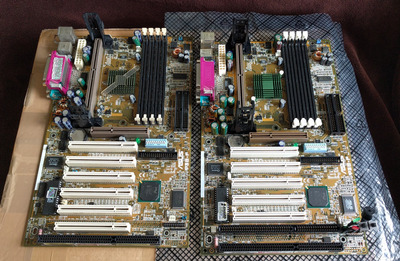

I have two ASUS P3B-F motherboards, both slightly different and from different locations.
The ASUS P3B-F v1.03 is from the UK, it has 2 ISA slots
The ASUS P3B-F v1.04 is from Japan, it has 1 ISA slot.
Notice from the photos, the difference in capacitor brands. Both the v1.03 and v1.04 appear to have green Sanyo capacitors. The v1.04 clearly has Rubicon capacitors on it, but it is unclear of the other brand of v1.03 capacitors. Can anyone identify the differences?
Notice the difference in capacitor layout. For example, CE33 and CT2 are missing on the v1.03. Perhaps this has something to do with the additional ISA slot on the v1.03 or the additional PCI slot on the v1.04 at the other end of the board?
I thought maybe this information may be useful to someone who has an interest in these boards, and could possibly explain why such differences occur on these boards, whether that be related to the differences in either layout or the revision numbers?

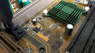

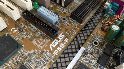

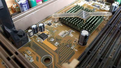

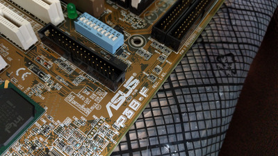

Additional photos of further differences.

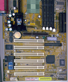

My suspicion is that the differences in the VRM layout are related to the update to VRM 8.4 that occured during the v1.03 .
The ISA slot does not seem to have anything to do with it - I have a PCI version of the v1.03 here and it has the same VRM layout as the v1.03 in your photos.

Yes, only revision 1.04 of the P3B-F officially supports processors with higher power demands (i.e. most Coppermine cores), see here.
The capacitor in location CE33 is not found on all boards. There are rev. 1.04 boards with and without it. Supposedly, it was a added as a fix for certain types of instabilities; there are even reworking guides to that purpose.

That is the 'official' interpretation but there must be a truckload of P3B-F boards rev 1.03 around in the wild with the 'old' VRM layout but that are accomodated with VRM 8.4 compliant voltage regulator chips. Both my PB3-F revision 1.03 boards for examplw are like that and support all Coppermines up to 1.1 Ghz.
And the rev 1.03 board in the photo posted by janskjaer has a Unisem 3007CW chip which is also VRM 8.4 compliant and that board will most likely also support all Coppermines.

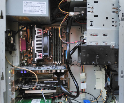

Reply 15 of 31, by PARKE
DenizOezmen wrote on 2020-07-04, 16:55:
My go-to board for PIII systems was (and is) the P3V4X, which was often derided for stability and driver problems, while I never encountered any glaring issues. It's really all down to the individual configuration.
Oh, yes,!
P3V4X reviews triggered my curiosity in the past because I thought it was maybe the only 'pure' Coppermine board that was able to beat the P3B-F in terms of raw speed. That was not the case (here) but they are very close and the 2Mb SDRAM allows for a relatively smooth Windows XP experience 😀
136.19 KiB
3823 views
