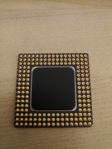

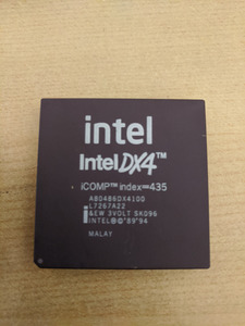

Just got a NOS DX4-100 chip but can't get it to post. Anything odd about it or did I just get a bad chip? Tried 3.0V-3.5V, nothing. System boots right up with the old DX4-100 &E chip. System a IBM Valuepoint 466DX2/Dp.
Do some systems not work with the write-back cache (&EW)?

Reply 1 of 45, by Horun
Hmm the only ones I have seen have a gold plate on the bottom (not painted), and some numbering on it. Am sure there are other variants but the lack of circled R after Intel in top line makes me suspect as Intel always included that because of registered copyright. Not saying it is fake but have a read here at cpu-world:
real ones: http://www.cpu-world.com/CPUs/80486/Intel-A80486DX4-100.html
about a possible fake: http://www.cpu-world.com/forum/viewtopic.php?t=13445
Reply 2 of 45, by auron
as seen in this intel document linked in the thread above, the dx2-66 and dx4-100 were indeed affected by the logo change, the SK096 s-spec matches up, and the (200)7 week 26 date code makes sense at a glance as well (deadline for the old chips was march 2007 according to that document, and they were only discontinued in september that year according to wikipedia). a dx2-66 looking just like that can also be seen here: http://www.cpushack.com/2013/01/26/cpu-of-the … tel-486-dx2-66/
can't say for sure that these aren't fakes, as the missing (R) seems odd to me as well, but if they are, the fakers certainly have put a bit of thought into these markings. but was there really a huge market for faking these in 2007 though? i'm assuming this would have been a final run of low-volume replacement parts for the embedded market, though i wonder about the actual prices...
Reply 3 of 45, by chublord
I did notice the die looks too big. Seems odd there would be a market for fakes??? I'm curious what it actually is. I'm tempted to turn it up to 5V and see if it's a phony DX2 or something, of course that would fry it if it's a legit chip.

Reply 6 of 45, by Socket3
Shouldn't there be some markings on the back of the CPU as well? I can't tell from the pictures, but it's fishy if there are no markings at all... the blank back makes me think of the dummy CPU's some retailers received for presentation and exposition back in the day.

Indeed, this is a weird one. I've seen these on Taobao for a while, and I was always kind of sceptical that these were legit.
As others have pointed out, the die cap area seems too big for a 3.3V intel chip. It seems to have the same proportions as the older .8 micron 5V 486s.
Actually, from the photos it almost looks like the die hasn't even been installed. It looks inverted, but I assume this is an optical illusion.
I suggest seeing if the black covering can be scraped off to reveal gold underneath. If it's a fake, maybe the real markings are covered up.
Reply 8 of 45, by imi
well the font doesn't look like an intel logo at all at least and the bottom markings are usually lasered and not printed:
edit: oh didn't see the post about the logo change, that's interesting.
Reply 10 of 45, by Horun
bearking wrote on 2020-07-25, 17:35:
Here is my DX4-100 SK096 with the old logo...
Re: I recently found this hardware, AKA the Dumpster find thread.
That is how the one I personally saw looked and it had gold bottom plate with some numbering, am sure yours does too (though have seen some 486 where the black numbers have faded/missing off the bottom gold plate).

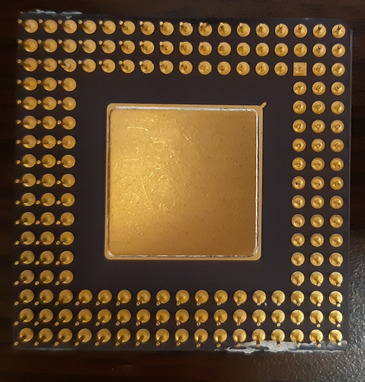

Reply 11 of 45, by bearking
Horun wrote on 2020-07-25, 18:49:
You made me curiuos, so I popped it out from the socket and took a picture of the bottom of it. Here it is...

Reply 12 of 45, by Horun
bearking wrote on 2020-07-25, 19:30:
Looks real ! Nice gold plate and Small die size compared to SX/DX cpu's. I should check my Intel DX4ODPR100, am sure bottom looks just like yours but is in a machine and hate to open it up.
