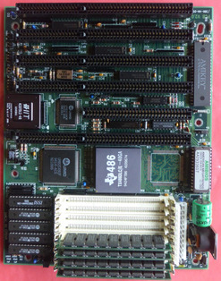

Take the M396F.
here's mine
Sometimes they come with a sticker above the chipset just like with 486 era boards.
Sometimes they come with a different alias

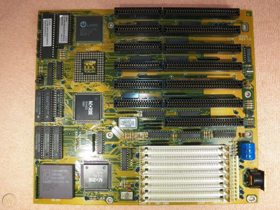

And of course the M396F isn't the only board impacted by this. Take this M326 :
As you can see they sometimes have a "Sarc" chipset ... But what is "sarc" ? They're only seen on pcchips boards it seems. I highly suspect "SARC" to be yet another pcchips owned brand which doesn't really exist and was used to rename chipsets.
When you compare the M326's chipset with this one, they look quite similar !

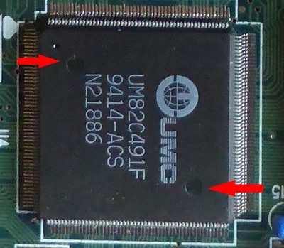

Actually I compared the SARC RC4018A4 to the UMC UM82C491F because that was the first chipset that looked similar that I had in mind ...
But what if it's really the same chipset ?
I now have good reasons to believe it's the same chipset.
27.14 KiB
2679 views
48.45 KiB
2679 views
Each chipset brand has its own "dot pattern" on the top of their chips. This one is matching umc's

One last hint : when you look on the top right of the SARC chip, look at the connections. There are several pins connected, then one not connected, then several pins not connected, and again a pin not connected.
You can see the same pattern with the UMC UM82C491F on the bottom left ! Relative to the pin #1, they're a perfect match 😀

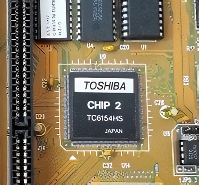

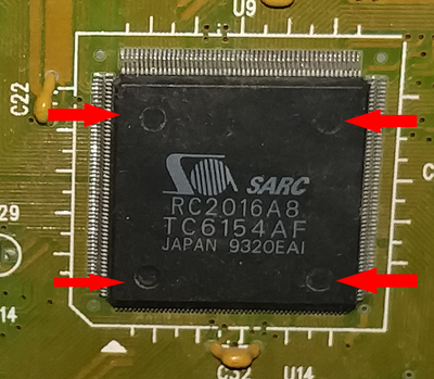

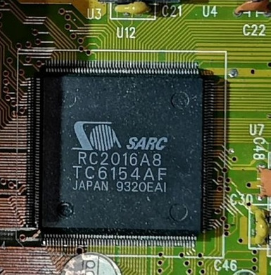

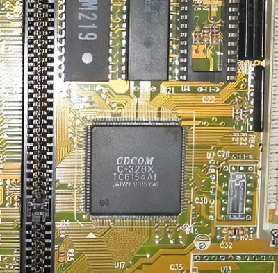

I was able to find some info about the SARC RC2016A8. It appears to be outsourced from Toshiba and it's based on the TC6154AF, a 286 chipset
http://chukaev.ru54.com/cs_full.htm#Toshiba
They relabeled this chip as CDCOM in some cases. Some even have a Toshiba sticker.

There is even a BIOS image from a board claiming to have a Toshiba chipset, you can find it here: http://chukaev.ru54.com/bios_cs.htm (at the Toshiba section)
You can see the boards here: https://www.phantom.sannata.org/viewtopic.php … =18687&start=66
They all seem to share the four dots with a regular Toshiba QFP package.

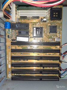

EDIT: found this board on a russian auction site:
136.63 KiB
2476 views
