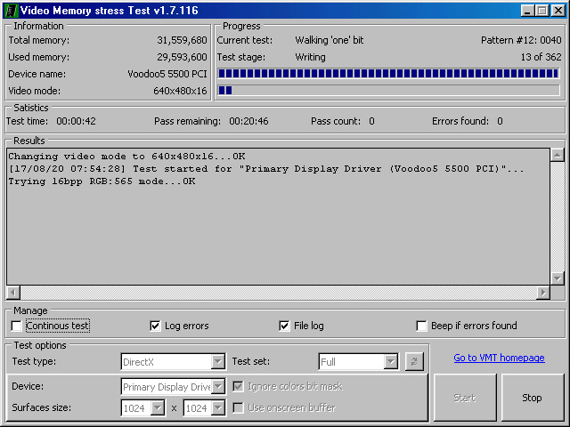

Reply 9 of 21, by paradigital
So VMT on my fully functional Voodoo 5 5500 PCI shows 31,559,680 bytes.
Reply 10 of 21, by avxstudios
paradigital wrote on 2020-08-17, 06:57:
So VMT on my fully functional Voodoo 5 5500 PCI shows 31,559,680 bytes. […]
Thanks!
This is relatively good news as that's how much windows VMT detects mine as having, and passes fine with, and passes in dos if that amount is manually set, I'm guessing dos version of VMT just doesn't know how to properly pull the right ram value for the ago version 🤔
Would be interested to see if anyone else with the AGP version experiences the same detection failure issue for dos VMT.
If I let VMT automatically detect in dos , it erroneously detects it as having over 135mb of ram, and manually specifying 32mb as 32mb also fails as VMT reads that as 33,554,432 bytes as apposed to the 31,559,680 bytes that the windows version sees it (and from your post, the PCI version too) of having.

Reply 12 of 21, by paradigital
Well, I tried to run the DOS version of VMT, but the top section of the screen disappears seconds after starting (I can see the statistics section, but nothing above that, it just goes blank white). The test continues to run, but clearly it's testing invalid memory areas as the test quickly starts racking up thousands of errors.
In Windows the test completes successfully, and in actual real world and synthetic benchmarks the card performs flawlessly, so I'm not particularly convinced by VMT, especially the DOS VMTCE version.
