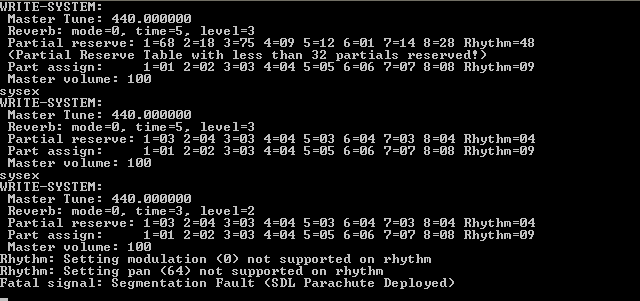

Reply 16 of 44, by gulikoza
Srecko: I can't get your code to work. I pulled latest Munt files from cvs, it compiled fine, but I always get a segmentation fault soon after the game tries to access mt32. Sorry for posting a screenshot, but dosbox didn't write a complete log before crashing (I did modify all Munt functions to use dosbox' own LOG_MSG).
edit: tested on sim city 2000 and ultima underworld 1.
