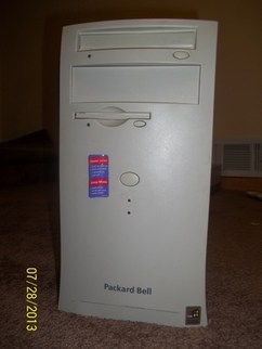

Back in '97 my family bought a computer, a Packard Bell Club 30. Whilst now (and probably then too) it is/was condsidered to be a bit of a turd, I have immense nostalgia linked to that machine.
As it is, I have managed to track down an old empty Club 30 chassis along with original 14" monitor and keyboard (no mouse yet) and have the desire to rebuild the case with original hardware/specs.
The main issue, however is tracking down the model of the original motherboard - which are probably few and far between now but I have the patience to wait 😀
I know that my Club 30 had the Cyrix 2 300mhz so would have been a socket 7 but it would be handy to have a model number or something I can use to keep scouring ebay.
I have been keeping my eye out for a complete Club 30 for ages but due to the renowned 'quality' of packard bell stuff most have been sent to landfill years ago.
I even have the original double packard bell restore CD's that went with my club 30 which I can't wait to install - although I've lost the key, I assume any win 98 for that service pack will work?
If I can't get hold of the original parts it would be a shame, but can always build up as a sleeper build for a modern machine or build a pentium 3/4 windows 98 rig.

Those PB model names can differ strongly between markets... is it the same "Club 30" in this article?
https://planetbotch.blogspot.com/2012/12/pack … or-nothing.html
If so it had a GVC FR500 motherboard.
Good news: I have one.
Bad news: it's been converted into a mouse mat 😜
(all components removed, varnished and soft rubber applied to the bottom)
Other possibility is a Biostar M5SIB. Both are nearly identical in terms of size, specs and features (SiS 5598-based), but the FR500 had 4x 72p SIMM and the M5SIB had 2x 168p DIMM. The FR500 was used a lot more/longer than the M5SIB, which was rapidly replaced by the GVC FR520 (SiS530-based).

"PB850" is Parckard Bell's internal name for the FR500, so yes, that's the board (at least, assuming your system had SIMMs not DIMMs). The M5SIB was referred to as "Pegase" - see here http://uktsupport.co.uk/pb/mb/pbmb1.htm
I'd consider that board idiotically overpriced for what was - it was bottom-scraping low-end stuff back in the day and would have cost less new. Problem finding this sort of thing is that basically nobody who is interested in what hardware they have would buy one, so your best chance is just to look for random low-end PB systems from the right period, and to do so locally. A lot of the other 'Club' systems, also ones in minitower chassis ("Squarius") had the same board. I'm looking for a quite different PB beast, a PB Bora Pro aka MSI MS-6168 v2.0 motherboard with i440BX and Voodoo3 onboard. Have two, but one fails to support Coppermine and the other has dodgy video memory, so still looking. Haven't spent more than EUR 35 on a likely system, and apart from the desired boards, I also found two FR520 boards. No FR500, but that's because I'm looking for one year newer and a different type of case. If you focus on the desktop chassis you already have (which will more commonly contain Intel MU440EX boards) and this Squarius I case you will probably find one soon enough:

Yes, that's a completely standard uATX case. Only slightly custom thing is the button/LED connector (single block with non-standard layout), but you can fit that on so that at least power button works.
In-between option is to look for another PB uATX board that would give you the PB BIOS splash screen and fit the button/LED connector.
Other PB uATX boards (with PB name behind vendor name):
Biostar M5SIB "Pegase"
GVC FR520 "Miami"
Intel MU440EX "Maui"
MSI MS-6147 "Tempest"
MSI MS-6168 "Bora Pro"
Gigabyte GA-6WMM "Apollo"
GVC DR724 "Skye"
MSI MS-6159 "Suva"
MSI MS-6323 "Luna"
Gigabyte GA-6WMM7 "Houston"
