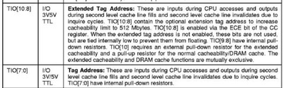

As long as there´s just one TAG-RAM socket present, the cachable area of the L2 cache is limited to 64MB of RAM. The single socket could even be populated witch a 32x8 chip (instead of the needed 16Kx8) without fixing this, because this SRAM design has 8 I/O lines only resulting in an 8-bit TAG-RAM bus-width.
For the Intel HX northbidge to enter the enlarged cache mode that allows all 512MB of RAM to be cached by L2 cache there need to be 3 additional I/O lines for a total bus-width of 11 bit.

The 3 used I/Os need to be connected to the pins TIO8, TIO9 and TIO10 of the HX northbridge.

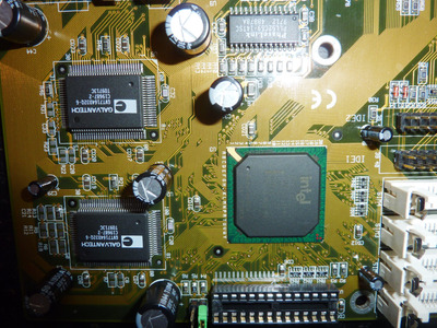

Now here´s the situation on one of my HX boards:
1.78 MiB
1408 views

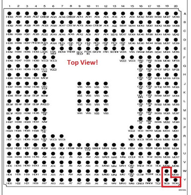

The problem is, if the pcb´s layout does not provide a second TAG-RAM, the needed pins of the HX-northbridge (that sadly comes in the BGA324 package) might not be connected at all. In my case I detected a trace for TIO10 (probably just in case TIO10 needs to be pulled up) but could not find any connections to TIO9 and TIO8 so far.
It´s possible that there are just isolated pads for the soldering balls.
There are countless small traces and vias on the green pcb of the chip where there´s no plastic coating but I have no idea where they lead...
Maybe someone has an idea how to get a grip on the 3 pins / pads?
Meanwhile I managed to find a connection with pin TIO9. No luck with TIO8 so far. I think I´ll give ot a try anyway and prepare a small daughterbord for two cachechips while searching for TIO8.
