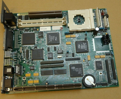

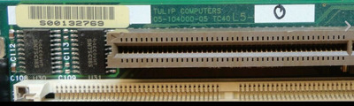

i have a working Unisys CWP4663 with 486DX2. I want to upgrade to a DX4 or Am5x86. Unfortunately I don't have the jumper settings for the motherboard.
The mainboard is manufactured by TULIP COMPUTERS part number 05-104000-05 TC40 L5. See attached pictures.
Does anyone of you recognize this mainboard and may have documentation that you can share?
Any help would be appreciated.
Thanks
Peter

Reply 1 of 13, by Horun
Hmmm that is the oddest method of adding a VRM to board I ever saw. Will check around for some info. An Intel DX4ODPR100 should drop in with current DX2 settings....

Reply 5 of 13, by Horun
PC Hoarder Patrol wrote on 2020-09-23, 01:37:
Great find ! Think better images of the motherboard could be helpful. Never seen a V. reg planted in a surface mount 486 cpu area before.

Reply 9 of 13, by peda126
Thanks to the posted link to the manual, got the system up an running with a Am5x86-P75 133 CPU! Great idea with the Wayback machine!!
BUT, with all my screwing around yesterday, i dropped the CPU 90 degree off in to the socket. Unfortunately i heard a "sssstt" and saw a small spark and it looks like the onboard IDE controller is fried..... I order a loupe to inspect all SMD parts in the are where is saw the spark, maybe i can identify the fried part and replace it.

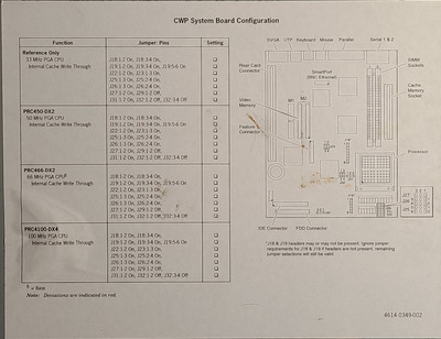

Reply 12 of 13, by gbin
Mine has a cool TLDR for the jumpers inside, I let that here for the future people landing on this thread in the future.
