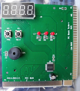

As mentioned in the "Bought retro hardware" thread I recently got this combined ISA/PCI POST card and I put it in my P200 machine to test it.
64.48 KiB
2080 views
In a PCI slot, no problem, blinking leds, changing codes on the segment display and the PC booted as always.

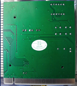

Next I decided to test it in an ISA slot, removed the ISA cards installed to easily access one of the 3 slots, put the card in the correct way, turned the power on, big mistake, no vga signal, no beeps, some burning smell came up, turned the PC off and looked at the POST card, you can see the damage:
65.56 KiB
2080 views

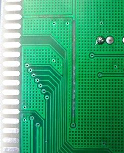

24.96 KiB
2079 views

How is that card supposed to work on the ISA bus!? Apart from the burnt trace, which seems like a clear indicator of a short circuit, the card seems to connect the following ISA pins only
  • RESETDRV - to display the reset signal.
  • +5V/GND for power supply (LEDs, control chip)
  • D0-D6, no D7!
  • not a single address bit!
  • IOW (to monitor I/O writes)
  • MEMR (maybe for a LED that shows BIOS access)
The burnt trace connects pins B1, B10 and B31. All of them are supposed to be ground pins. If the card was inserted in the right orientation (i believe you that you got it right. You know where to expect the component side of an ISA card), and in exactly the right position, connecting the three ground pins can not cause any damage and can not lead to burnt traces. But take a look at how short the ISA connector is on that card compared to an regular ISA card, you will likely discover that the unused PCB space left and right of the 31 connections each side is missing. This allows the card to be misplaced by half a pin at least. Now that makes some sense. Pin B9 is +12V. If you short +12V into something expecting 5V at max, you might very well get damage! If the pad for Pin 10 touched pin 9 well enough to pick up +12V, but pin 10 badly enough to not short the +12V out in-place at that position, the pad for pin B31 most likey connected to pin B30 instead. That sounds like very bad news 🙁, because that pin is OSC, the 14.318 MHz main oscillator of the IBM PC, also clock source for the IBM CGA card. This pin is mostl likey directly connected to the OSC input on the PIIX3 south bridge (pin 136), which will not like +12V on that pin at all.
Something must have shorted the +12V from the supply towards +5V or GND to cause the trace to burn. That device that shorted the +12V line might have just used the internal protection diode for that, so the +12V were shorted into +5V. But the protection diodes are made for a couple of milliamps, not a couple of amps. So it likely overheated and caused collateral damage. The source for the OSC signal is most likely the main clock synthesizer chip. That clock synthesizer chip seems to still be alive and kicking, otherwise your system most likely wouldn't power up at all, but if you are lucky, just that chip is damaged. That's the "PhaseLink" chip next to the Dallas chip on the P55T2P4, which can be swapped by hand soldering (with some experience!).
A first step for damage assesment would be to check the OSC line on the ISA bus (B30) for shorts to +5V (B3) or GND (B1), because an overheating protection diode might have gone short. Also you might want to check the trace for OSC on the mainboard for burn marks, especially interesting is to find out, what parts are burnt and what parts not. It is likely that the end of burn on the OSC line (if there is any) is indicating what chip caused the +12V to be shorted out.

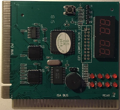

I have a card similar to this. PCI is fine, ISA didn't work at first but nothing bad like that. Then I inserted it the correct way and it worked. By rear it means rear of the PC and not the rear of the slot.
Reply 4 of 13, by mkarcher
RichB93 wrote on 2020-10-09, 23:12:
I also have a copy of that card. In contrast to the card in the original posting, this card has a proper width ISA edge connector that prevents misaligned or tilted insertion into the slot. I stopped thinking about what kind of "rear" they mean and I just go by "on what side would the components be on a regular ISA/PCI card" and plug that card the same way. I don't even bother looking for the "rear --->" mark any more.

I have that same card pictured above as well. Only have used it a few times but it has never given me problems. The one in the OP looks like a really cheap version of the already cheap Chinese post card like the ones we have.

I have a similar ISA/PCI POST card (with 5 logic chips) and in it's manual it states: If inserted wrong direction in ISA slot it can cause damage to card, motherboard or both.
I too once put it in wrong in an ISA slot but it did no damage to anything,
cyclone3d wrote on 2020-10-09, 23:46:
Agree ! the OP's card has just one logic chip so assume it is a lessor quality product than the 5 chip versions.
Also in the manual it states that: some motherboards will not give proper codes from ISA slots if PCI slots are present depending on BIOS and chipset.

They should sell this ultra-cheap edition as PCI only and do away with the broken ISA connector. It misses at least 9 connections to the ISA bus (A0-A3, A6-A9, D7) that are necessary for kind-of proper operation (real proper operation would also decode A4,A5,AEN), so I don't see how it will ever work in an ISA slot. This applies even if you manage to align it correctly. Seems like they didn't finish the ISA side of the card until production time.
I would recommend lolo799 to use a compact angle grinder like a Dremel to remove the dangerous and non-functional ISA connector from the card to prevent accidental killing another main board. Is an ISA post card is needed, by the "real thing" instead of the cheap clone of the common cheap card. As it looks, the PCB is 2-layer only, so using an angle grinder does not risk shorting internal layers. Looking at the possibility of inner layers in more detail: They did connect the three GND pins and they did connect the two +5V pins on their attempted ISA bus card egde - but the did not connect that to the power rails of the card. Also: they installed the speaker, but "forgot" to install the 2-pin header for the cable to the mainboar speaker output. Just WTF?

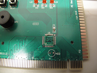

might as well add my 2 cents....
The one chip card is in no way usable for post codes on the isa bus.
the chip is not even connected to the isa bus.
I bought one, tried it, removed the chip and noticed the traces just ending there.
