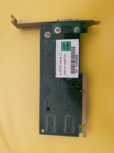

I have both, but I am not sure which has the best 2D picture for DOS, and best overall 3D performance. Then again, I am planning to play all my Win9X era games (Quake, Quake II, Hexen II, Unreal, Half-Life) in pixelated, non-3D mode, I like them chunky pixels.

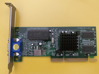

The Serpent Rider wrote on 2020-10-13, 11:39:
For DOS, Vanta LT would be better. VBE 3.0 support and better performance. Image quality may vary, but I had good experience with reference OEM Vanta LT card.
Thanks. Mine looks like this
Also, for DOS, I only play at 640x480 (and lower) resolution, so I don't think VLB would be a big selling point here for me.

Reply 7 of 9, by The Serpent Rider
That's Sparkle. Most likely average image quality.

The Serpent Rider wrote on 2020-10-13, 16:57:
What is Sparkle?

Reply 9 of 9, by The Serpent Rider
Brand.
