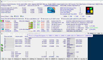

Reply 17 of 47, by red-ray
gbeirn wrote on 2020-10-18, 06:55:
I thought Windows dropped support for 5.25” drives with some version but I’m not sure.
I just checked my Gigabyte 965P-DS3 and the BIOS allows a 1.2 MB 5.25" floppy to be selected, further Windows 10 20H1 Build 19041 seems to support it, but as I don't physically have a 5.25" drive I can't check if it works.
To access 3.5" floppies I think you could use an LS-120 which as I recall has an IDE interface.
file.php?id=94345
    104.47 KiB
    1864 views
    W10 seems to support 5.25" floppies

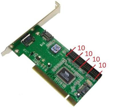

Reply 19 of 47, by Tetrium
Spiffles wrote on 2020-10-17, 13:30:
Do these cards actually let you mount floppy drives on any board with PCI sockets? https://images-na.ssl-images-amazon.com/image […]
24.15 KiB
1858 views
I doubt it, unless your intention is to use a USB (external) floppy drive or an LS-120 drive (which are capable of operating some of the standard floppy disks, but may come with its own set of problems).
