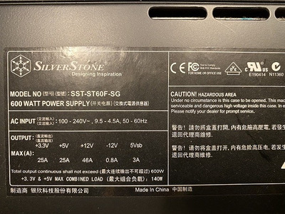

Reply 6 of 36, by Valentyn
The Serpent Rider wrote on 2020-10-17, 18:48:
You want at least 30A there for high-end AthlonXP CPUs.
That's a common myth. You don't need that much current. Modern PSU with 25A should more that enough.
I have a Silverstone SST-ST60F-SG, and it states 5v 25A, with a combined 3.3v + 5v of 140W.
Think this will do the job? It's a small form factor one, might need to get some SATA to molex power adapters, as it only has a single molex.
Keep in mind the motherboard doesn't have a 4pin power, just the ATX power connector.

Reply 11 of 36, by ohhwell
Joseph_Joestar wrote on 2020-10-17, 18:46:
Don't just look at the watts, check how many amps are on the 5V rail. You want at least 30A there for high-end AthlonXP CPUs.
I ended up getting a used LC Power branded PSU from the early 2000s for mine, and it has served me well so far *knock on wood*.
You see, you actually should be looking at watts if you don't know what you are doing. If you had then you would have realized that the 1.65v at the max draw of 41.4 A is indeed the 68.3 W TDP they list for the 2600+ in the spec sheet you listed. Getting that wattage from a 5v rail would simply be 68.3/5 which is.... 13.662 Amps (15.7 assuming 15% efficiency loss in conversion from 5v) so yes, a PSU with a 25A 5V rail is plenty.
I know this thread is a little old at this point but it was the first result when I google searched and yes, The Serpent Rider already pointed out your error, I thought it would be good to expand on it a little for posterity.
