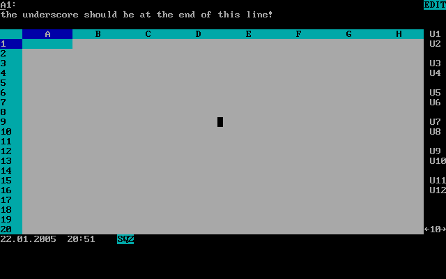

DOSBox can run Lotus 123 (version 2.4) just fine...except that you can't edit the spreadsheet entries!
I mean, I can get in edit mode (using F2), but then I can't move left/right and delete anything.
The edit character (underscrore) is mysetriously kept under the cell ID (A1, A2, etc.) instead of under the cell's contents (like it should be).
So I can add new ones, but not edit them without rewriting.
What do you think could cause this?
And does anybody else here have this program and can test it?
Reply 1 of 8, by lwc

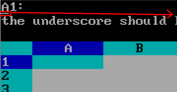

Ok, turns out that editing works. It's just that you can't tell where the underscore is at (since it's always displayed under the cell's ID).
Here's an image (including a zoom) to demonstrate the problem.

    And a close up zoom.
    5.73 KiB
    2588 views
    The underscore shouldn't be under A1!

Reply 6 of 8, by Qbix
Rank DOSBox Author
DOSBox Author
the game doesn't use int10 while running.
it programs the vga registers directly and doesn't update the int10 bios part.
This causes the problems. (as the mouse cursor uses the int10 bios data to)
I fixed the mouse so that it doesn't use those data anymore.
Now it works allright.
