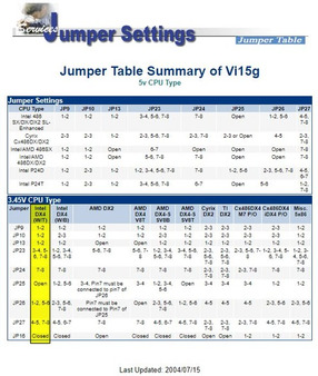

AOpen Vi15G Jumper Documentation Details
Though I would like to point out that the documentation I found online for the Vi15G on the typical sites were not complete. Specifically elhvb and stason.
I know at least two versions of this motherboard exists, the 5V only version, which is the one I have, and then the 3.45V version, which is what LGR has. This in itself really isn't a deal breaker, let alone an issue in the grand scheme of things. However, this does mean the documentation also is missing a lot of jumper settings for the 3.45V version. Which also is applicable to the 5V version when it comes to using CPUs beyond a 486DX2*.
(Asterisk on that to state that you must use a CPU that supports 5V, an Overdrive chip, or an Interposer. Since the latter two have a voltage regulator.)
That said, I wanted to make sure to document this because I've searched all over Vogons and other internet sources and I could not find any accuracy in settings to match my configuration specifically. The issues caused by this resulted in the system to not be capable of rebooting via CTRL + ALT + DEL nor by software issued reboot command. This was resolved by using the correct jumper settings for my 486DX4 CPU listed by AOpen's actual documentation hosted on their FTP:
ftp://ftp.aopen.com/pub/tech/jumper/vi15g/default.htm
To preserve these settings in the event that anything could happen to an ftp site these days, I did save the documentation and made a screenshot for anyone to reference this:
The CPU I have installed is the Intel 486 Overdrive. (DX4ODP100 - Sz957).
So I definitely hope this will help anyone who happens to have the same motherboard as this, either version they may have. I've already given the settings I've found to LGR as well.

hi, friend. I know this is an old thread, but it's the only place I've found to ask.
I have that same Acer/AOpen VI15G motherboard (actually, I have two), the revision with a voltage regulator and support for 3.3 volts. It is part of my two old PCs, stored about 16 years ago and that nostalgia has made me want to put them together again (the other is a pentium).
I remember that I had it with an Am5x86 installed, or so I think, but since I wasn't sure I changed the configuration (I forgot to write down the previous one, a pity, and important!). In the documentation it mentions a "Misc 5x86", but with that the 5x86 did not work. Then I read that it is the one corresponding to Cyrix´s 5x86, and that it was best to use the configuration for the Intel 486dx4 . however with this configuration I measured 5 volts in the socket!! I tried with the configuration of the AMD DX2 and Dx4 and if I got 3.45 volts. The bad thing is that this was after testing the 5x86 with the intel configuration, so I'm afraid I fried it. but I have another 80Mhz Amd 486dx2 and a 33mhz DX (3.3v). I tried with the DX2 anyway, the board does not boot, nor give beeps, anything
two questions
Do you have any idea why with the configuration for the intel dx4 it is giving 5 volts?
Could you share the configuration of the jumpers you are using?
