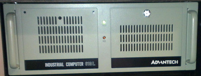

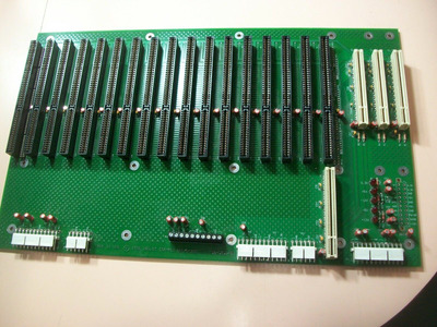

Reply 7 of 22, by cyclone3d
Soooo... I ended up finding a 20-slot backplane for really cheap so I bought it. 17 ISA + 3 PCI, which will give me the ability to have a max of 16 ISA sound cards.
Doesn't have a keyboard port so I will have to wire one up from the SBC to the case but that is not a big deal. I also don't have a 20-slot industrial case so that will be another thing I have to get or make.

Reply 9 of 22, by Pierre32
cyclone3d wrote on 2020-11-01, 05:40:
I'm hoping to score a retired industrial rig from work soon. The case at least is the same brand as your SBC. I'm looking forward to finding out what's inside.
