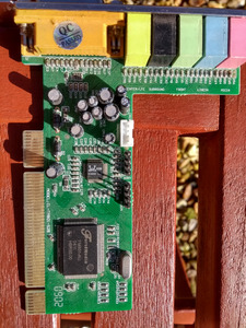

I was given an old PCI soundcard, model# on card is CL-FM801-S2B. One of the chips on the card has Fortemedia FM801-AU written on it.
I am trying to get it working in DOS 6.22, on a 440bx motherboard but can't get it detected.
Running the two standard TSRs to initiate a FM801 card (CF801.exe and DOS801.exe) both give the error message 'No FM801/FM1000, device does not exist'.
One odd thing I have noticed, running NSSI, HWINFO, ASTRA or Speedsys in DOS and looking at the PCI devices listed in those programs , the soundcard is shows as a 'Creative Technology SBLIVE! OEM'd for DELL??' on IRQ7 with 'Vendor ID 1102h/Device ID 0006h.
download/file.php?mode=view&id=95361
Is this a fake fm801 card, anyone come across these.

Congratulations! You got a Chinese card with a remarked chip.

I highly doubt that that is a real FM-801 chip. It is very obviously a cheap Chinese made card and they are very well known to have made a bunch of different fake cards. They would come with a cd with drivers for what the card really was but in Windows Device Manager they would show up as the card they said it was... Simple .inf edit is all that it takes.
But when you go to try to use the real drivers they won't work because it is a faked card that came with faked drivers.

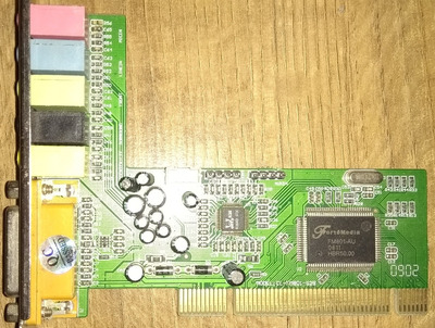

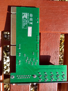

Reply 10 of 22, by Riikcakirds
I took two better pictures of the front and back of the card.
download/file.php?mode=view&id=95392
download/file.php?mode=view&id=95393
The FM801-AU chip on this card has 20 pins on each vertical side and 30 pins on each horizontal side (total 100 pins).
FM801-AU datasheet shows 25 pins on all sides, so clearly different layout but total pins still 100.

Reply 11 of 22, by darry

Yep, no DOS support. I highly doubt there will be any DOS drivers available for that chip.
Yamaha YMF7x4 Guide
Epstein didn't kill himself
Reply 17 of 22, by darry
cyclone3d wrote on 2020-11-03, 16:26:
Looking at the card photo, I see no sign of the serial EEPROM that would be required to fake the PCI device ID of an actual FM801-AU . I am now more inclined to think that this may indeed be an actual EMU10K1x based card . If that is the case, I do not see why someone would go to the trouble of silkscreening the chip as FM801-AU and even having PCB markings that mention the FM801-AU . Was that Fortemedia chip so desirable at some point that such fakes would have made sense to make ?
Reply 18 of 22, by pc-sound-legacy
The FM801 card layout is different and the IC is quadratic so I also think this is a fake, too. And there is no creative card with this layout, either. Try Crystal CS4280 driver instead as this IC was found on the chinese yamaha XG fake soundcards as well.
Reply 19 of 22, by darry
If this card is not based on a EMU10K1x and does not have an EEPROM, how is the PCI device ID faked ?
Do some PCI audio chips have an integrated (E)EPROM that allows programming a custom PCI device ID ?
