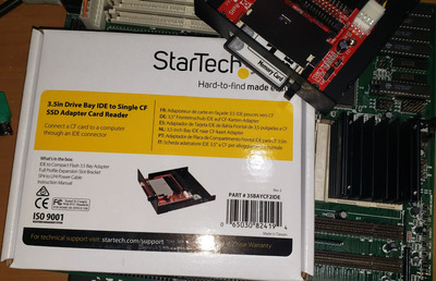

I've tried several controller cards, but it seems no matter what I do, I cannot get the BIOS to detect my CF2IDE "adapter" (I know it's mostly just a pin converter, but still)
I know the controllers are good because the floppies work fine, as does the 98 boot disk detecting (and successfully reading) my CDROM drive (IDE mitsumi 24x, oldest one I've got atm)
Pulled the bios and stuffed it into my EEPROM programmer and dumped the bios just so I'd have a backup and I have found a supposed bios upgrade that I'm about to try, but I was wondering if anyone had any advice on this topic?
(The CF2IDE is one of those newer StarTech ones from Fry's, with a generic 1GB card in it

    StarTech CF2IDE w/ 1GB Card Inserted

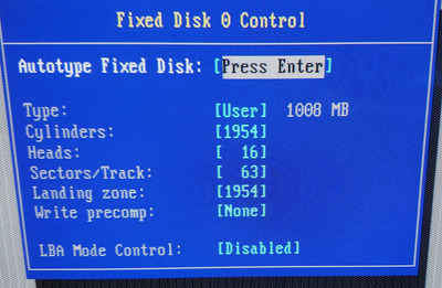

Yeah, it won't detect. I've tried manually setting C/H/S to try to get at least some use out of it but I always get "Fixed Disk Error" on that drive when POSTing.. I'll try with your numbers to see if it yields any better results.

    ECS-UM4980 detects StarTech CF2IDE w/ 1GB CF Card

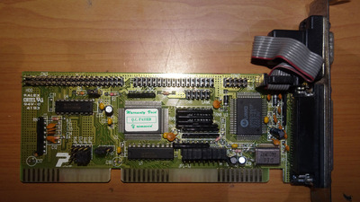

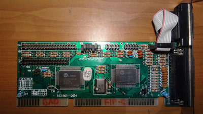

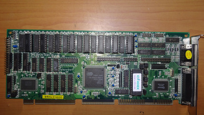

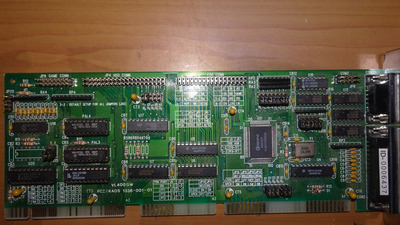

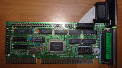

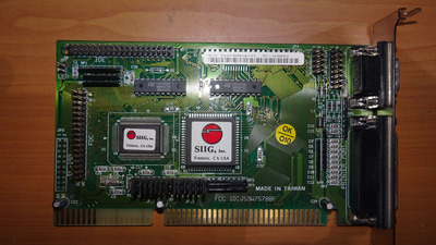

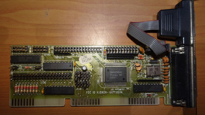

The combination I'm using at the moment is the Cirrus Logic VLB for video and currently IDE as I cannot get the stupid interface to disable (regardless of "JP3" setting.. Perhaps it's the soldered joint middle-left?)
Along with the AWE64. -- I'd prefer the SB32 as it has OPL3 AND CQM or w/e it's called, configurable via software, but if it's inserted into the mobo, IDE detection fails on the Cirrus Logic, eventhough it doesn't actually have an IDE connector, just the vacant solder joints for it.
The SIIG controller is the newest/fastest I've got, I think, and it's what I'm using for floppy and serial I/O. If I can disable the CL-VLB Video's IDE, I'd like to use this SIIG for HDD/CD as well.
Split between here and next post.

    UMC UM82C865F "KALEX K368"

    UMC UM82C863F 863/865-DO4

    Winbond SNB-C042

    SIIG SC-JKA052
Reply 18 of 22, by mashrien
Next set of images.

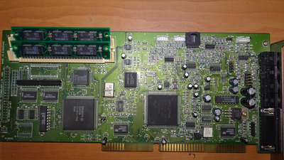

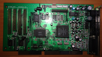

The CT3600 SB32 conflicts/overwrites any other IDE controller and won't allow them to detect in the bios. There is not actual pinout soldered to the board, just a blank socket for it. I'm assuming the jumper right next to it is to disable the IDE interface, but again, there's no actual pins there so I can't jumper it without soldering the board (something I'm capable of doing, just want confirmation before I go about modifying a collectors item)
The ideal IDE controller would be this VL400GW VLB bad boy, but it gives errors even with just a floppy connected (seems the card is dead~ish)

    GoldStar Prime 2C - U3 PRIME2C-30 KJDKEN-IDEPLUSv4

    Analog Devices AD90609 QS-833 Multi-Interface CDROM Cuntroller

    Winbond VL400GW KAOS 1336-001-01 ISA-VLB

    SoundBlaster 32 / CT3600 1MB
