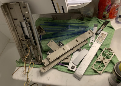

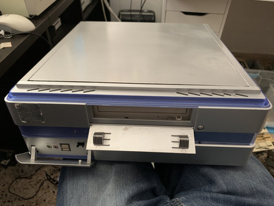

I need some help finishing repairing this computer.
It contains a socket 7 Delhi -III motherboard with Pentium 233 mmx.
On boot it shows the eMachines logo.
It was dirty beyond believe. Took everything apart, cleaned, lubricated the fans and put it back together and it is working great. Running dos 7.1 and wfw 3.11 with LAN.
Two last issues are with the case.

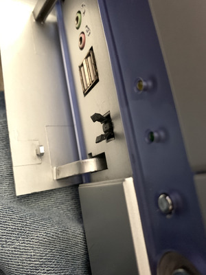

As you can see, the doors for the cd and the usb/audio do not close.
Where can I get the... thingy.. that hold the expansion door close? What is it even called? It seems worn out and would not hold the door close.

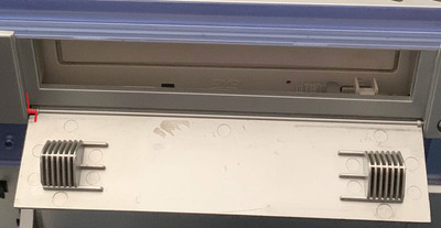

The CD door is another issue. I have no idea how it is supposed to be closed. Maybe there is a missing spring somewhere?
If there is anyone with a similar case it would be helpful if they could take a picture of the inside of the cd door.
Thanks 😀

I was able to find the catch/latch thingy on ebay:
https://www.ebay.com/itm/Replacement-Catch-Co … re/163950863327

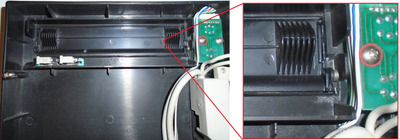

Like this Soltek EQ3901A case:
Reply 2 of 10, by SSTV2

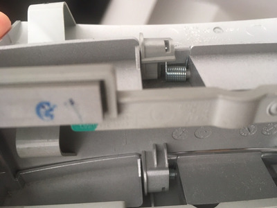

The closing mechanism of this bay cover probably is implemented differently, but perhaps it'll give you some ideas.
695.73 KiB
269 views
635.6 KiB
269 views

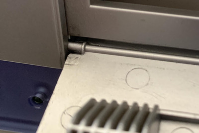

Reply 4 of 10, by aha2940
anetanel wrote on 2020-11-10, 09:16:
Thanks.
Indeed it is a different mechanism. I don't see any place a spring could be placed on my door :\
In the upper hinge of your door there seems to be space for a spring like this one, taken from a Dell machine:

for the usb door id probably just remove the black snappy thing, so the door would close. Then I might looks to see if its possible to change the door to use magnet to close, like how modern cases use magnets to hold doors and flaps in. I mean u could just cut off that thing on the door put square magnent there and glue a metal square on the inside.

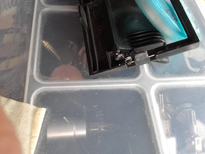

Reply 8 of 10, by PC Hoarder Patrol
Thanks.

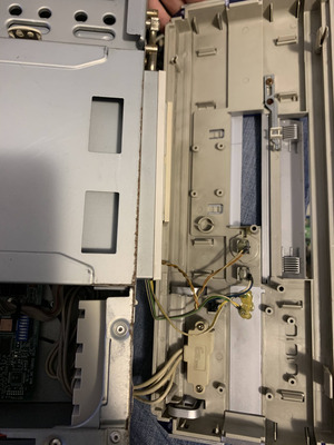

This is a pic of the inside bezel on my Iwill XP4 EVO (similar but smaller than the Soltek case, which luckily spends most of its life in bits!)
866.3 KiB
126 views

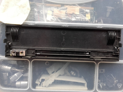

In your case I'm guessing a similar spring lever may have gone here
211.32 KiB
126 views
or possibly a concealed spring lever might have been located between an inner and outer bezel (does the outer silver bezel actually detach as marked?)
23.56 KiB
126 views
Reply 9 of 10, by anetanel
PC Hoarder Patrol wrote on 2020-11-18, 06:08:
In your case I'm guessing a similar spring lever may have gone here […]
I think you are right. upon closer inspection there seems to be some scuff marks where you suggest a spring could be.
160.29 KiB
114 views
And yes, the silver panels are detachable. There is an enormous amount of plastic in this case 😀 cleaning it all up was a task.
