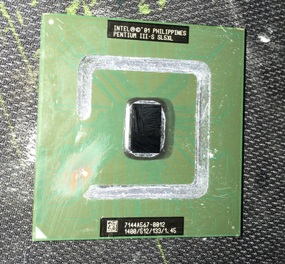

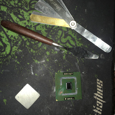

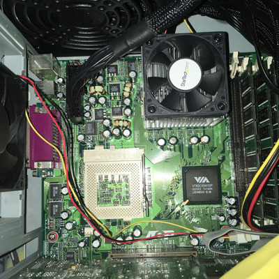

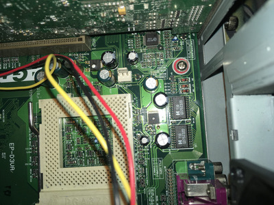

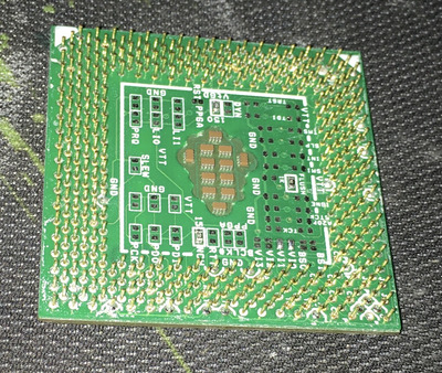

Update: Ouch i screwed up both CPU’s but fixed my motherboard and ended up replacing the cpu’s. Will never do this again, blades just don’t work in this situation. Original post: I decided to Delid my Retro PC build as i have successfully Delidded many PS3 consoles. But the same method didn’t work on one of my CPU’s. As i ended up scratching multiple traces and slightly damaging the dye. I scraped some of the paint off with a fiber glass pen to double check, and yes the traces were damaged . But the second one seems like it was a success as i used a different method using my thinner 32 gauge knife and could not find a scratch. I ran the PC with two of my CPU’s before checking for damaged traces. But one of the semiconductors next to the damaged CPU on the motherboard got fried. I removed the damaged cpu and the pc seems to be running fine. With the other CPU, nothing else is getting fried. But i get no video signal. I will be replacing the semiconductor. And as these CPU’s have adaptor sockets installed. Is there a way to desolder the adaptor? Update: I’ve successfully desoldered the adaptor using a rework station.

I don't want to be offensive, but delidding Tualatins is a stupid idea. What exactly were you aiming for ?
Delidding addiction i guess. It was pointless. I thought it would be easy but it wasn’t. Don’t think it will make much of a difference. I will replace the parts and see what happens from there. The temps were roughly around 50 Degrees Celsius.

Is there a reason why one of the parts on the motherboard got fried? I thought motherboards of this era would shut off immediately. And if it was running the other cpu without frying anything else. Does that mean that i’ve successfully Delidded the other?

Whereas why that component burned, I've had the exact same thing happen on me a long time ago with a P3 Coppermine, which had a cracked die. Wish I had a closer look at the CPU before using it.
