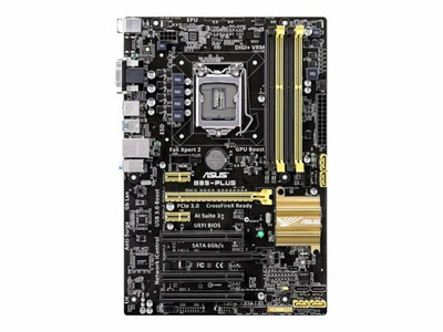

Attempt #1 - Asus B85-Plus, i5 4460, HIS X1050, 40GB Seagate SATA drive
44.35 KiB
806 views
At first, I decided to take an aggressive approach and jump straight into the UEFI era on my main PC (which proved to be a waste of time, avoidable by research).
Windows 98 installed fine and surprisingly fast (whole process lasted under 10 minutes). But the fun stopped here, because the GPU was not getting recognized. Furthermore, the PCI slots on this board are controlled by an asmedia chip, which 98 has no idea what to do with, which meant no audio cards will work.

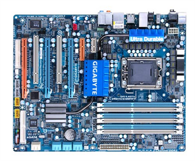

Attempt #2 - Gigabyte EX58-UD4, Xeon W3570, Asus EN7800GTX, 160GB WD VelociRaptor 10k (limited to 82GB by BIOS)
339.2 KiB
806 views
After the first fail, I did a little more research and discovered that my secondary rig was the perfect candidate: it had an Award PnP BIOS v6.00pg, the holy grail for Win9x resource management.
I also decided to swap the Seagate drive for something faster. I did not have a spare SSD, so I chose the next best thing, a WD VelociRaptor I had laying around.
The installation time was even shorter this time.
At this point, I found out that my 7800GTX could work in 98SE with an unofficial 82.69 driver, which I found here: https://toogam.com/software/archive/drivers/v … fici/nv8269.php
After a few tries, I got the system working at 1680x1050 in 32-bit color, quite a landscape given the scaling of Win9x desktop elements.
I also decided to throw a SB Live in there, which installed without any issues.

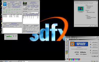

I installed 3dmark99 and did a first run at 1680x1050 32-bit depth, with stock CPU settings.
281.91 KiB

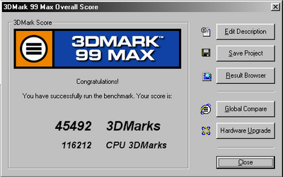

Then I did a second run at the same resolution, but with only one CPU core, 4GHz locked, no HT.
18.02 KiB
806 views
The CPU score went up by a surprising amount.

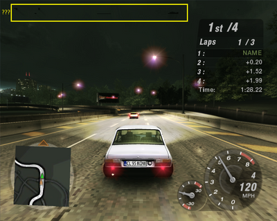

As for games, it's a mixed bag for now. Some games had serious frame drops, like GTA San Andreas, and some games,like Need For Speed Underground 2, experienced weird visual glitches but ran fine (dark spots at the top of the screen and mini-map out of its border).
1.11 MiB
806 views
The same games run perfectly fine under XP.
