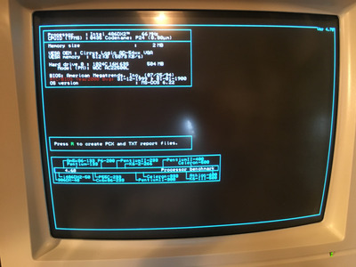

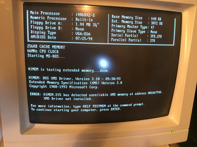

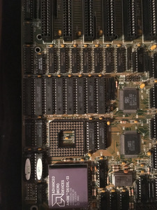

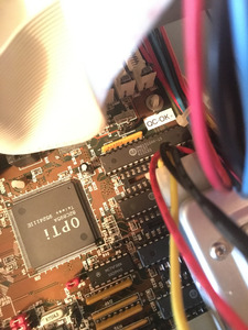

I've been tried to get a new motherboard purchase up and running.
After much testing and troubleshooting I have determined the cache is faulty.
I have some chips I have pulled from a dead 386 motherboard, and was hoping to use these. However I am unable to find any information on them online (I am hoping they are compatible with my board). Can anyone shed some light?
I've attached some photos.
Installation history as follows...
FYI the board arrived with the CPU voltage regulator snapped clean off.. thankfully I had planned to use a 5volt 486DX2 66. The board is booting with this fine.
1. Tried various ram combinations. Seems the system will only POST if the 4 simm slots are all populated. Ram at boot totals 3712KB
2. Found working HDD, Installed dos 6.22 OK. Rebooted a few times with no issues.
3. Did some cable management...
4. System boots and starts giving a XMS error (see pic attached)
5. Tried replacing all ram chips. No change
6. Disabled external cache and error goes away
7. Enabled cache (error returns) and tried a few dos operations - system unstable
8. Disabled cache and system is stable
Is is strange the cache initially seemed to be fine. Then the XMS error started after I was (carefully) tinkering in the case adjusting the layout.

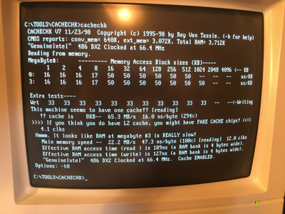

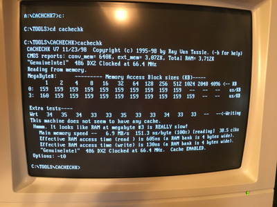

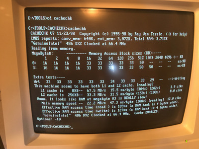

OK so I just ran CacheChk with my external cache disabled and internal enabled. Why would it not pick up my L1? Also is the "It looks like RAM at megabyte #3 is REALLY slow!" message to do with my external cache?
I tried swapping out all the ram modules and got the same result.
Cheers

Reply 3 of 19, by stinkydiver
OK so I've removed all the cachechips and still getting the slow RAM at megabyte #3 message.
However, when I enabled the external cache in the bios and rebooted it is now saying I have 512KB installed after post!? (prior it was 256KB, when enabled)
Take that there and put it in here
Reply 4 of 19, by cyclone3d
Is turbo enabled? Usually weird low scores are because turbo is disabled... Look for the turbo button header.
Some boards change bus speed, some disable L1 and / or L2 cache or some combination of all with the turbo button.

The turbo headers have nothing attached at the moment. I'll double check the bios, but I am pretty sure having the turbo enabled/disabled has no effect.
Also, I tried disabling the internal cache and the "RAM at megabyte #3 is REALLY slow" cachechk message went away...
Is this motherboard spitting the dummy or is the behaviour of some bad jumper settings somewhere (I can't find the exact manual which doesn't help. Only boards with a very similar but not exact layout)

Reply 6 of 19, by Horun
🤣 love the topic you chose: "Cache woes. Is it Faulty or is it the Motherboard being spastic?"
Are all the ram SIMMS the exact same ? If not could explain the "RAM at megabyte #3 is REALLY slow". Also try cleaning the simm sockets and simm edge contacts with ISO Alc.
You should also try the cache chips again, make sure you inspect each socket and then insert them firmly (press hard after carefully inserting), make sure you put them in correctly.
Before running any tests reset the BIOS to defaults. You have 25nS cache chips which require extra wait states at 33Mhz versus 20nS of many other boards.
Just checked and all of my 386 have 20nS cache chips with 15nS TAGS, even my Asus 386 ISA-386C (first board built and retail sold by Asus) has 20nS cache chips.
If still errors I would double check the BIOS settings as it might have cache speed/wait states set wrong.

Reply 8 of 19, by jakethompson1
You're super sure on the turbo? Maybe put a spare jumper cap over the turbo connector and boot with that?
Those cachechk speeds are deplorable. It has nothing to do with megabyte 3 in particular.
Reply 9 of 19, by stinkydiver
Thank you good sir!
I put a jumper over the turbo pins and what would you know....cachechk is looking much better!
Now ill add the cache chips back in and see what happens!

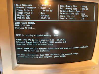

Reply 10 of 19, by stinkydiver
OK I reinstalled the cache. I seem to be frequently getting the XMS error at boot. Initially it was loading dos fine, other times it will error out..

Reply 11 of 19, by jakethompson1
If you reboot say 10 times and keep track of the address where it fails, what digits does the address end in? Looks like 4 in both your screenshots. This might be able to tell you which cache chip is bad
Reply 12 of 19, by stinkydiver
Ok so I rebooted 10 times. The 10th time it booted fine. All other times I got the XMS errors with the following addresses (in order)
00166794h x3
001663d4h
00166310h x4
00166190h x2

Reply 15 of 19, by treeman
It could be a line form cache or memory losing connectivity, signal is lost sometimes and not others.
If you had a external programmer like a tl866 you could check the cache chips direct and rule them out
Reply 16 of 19, by jakethompson1
treeman wrote on 2020-11-27, 00:27:
I was going to suggest that, but I had a similar issue to this where all four chips passed the TL-866 II. I ended up narrowing it down to one of the chips and replacing it.

Does anyone know how to ascertain what KB size those 25 chips will be? There is no point in trying them if I cannot set the jumpers to the correct size settings on the motherboard.
Reply 18 of 19, by cyclone3d
Looks to me like they are 64Kb chips, so you will have 64KB.
I think you should be good till a 25Mhz or 33Mhz FSB with those 25ns chips since the tag chip generally needs to be faster than the rest of the chips.
