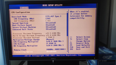

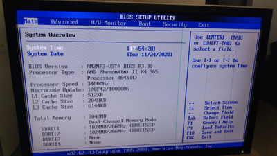

After some trying, it boot. I can see the bios, is the last version, and it is correctly recognized as it should be. A Phenom II 965 3,4ghz. At that point I decided to set bios better, I disabled things that I don't need, I put the overclock in Manual mode, and I set the 1,45v. on the CPU.
I shut down and I start, all was ok. I installed Windows XP, all gone right. I was happy cause I thought I had solved my little initial problems, I tried a little overclock too. My Phenom II reached 3,6ghz with 1,425.v I don't want to stress it so much. (Anyway probably I am video card limited considering AGP slot and with a 9800PRO and a X1950PRO this Phenom II is probably too fast).

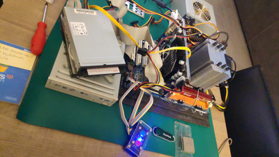

All runs fine, games runs fine so I decided to find a case and put all the great hardware inside. (look at the photos attached).
This morning I made a nice work, I packed all inside the case and after about one hour of nice happy work, system WON'T BOOT ANYMORE.

So this evening I'm here to try to understand WHY before of all, and try to find causes with you.
Some of you have any idea?

There is some setting that I HAVE TO FIX or SET before plug the Phenom II another time? Do you have some advice?

I plugged all the cables, I have a nice Enermax FMAII 460W power supply, and yes, the battery of the bios is in perfect shape (3,1volts).
I am looking for a nice advice, for the moment I attach you some photos of this old/new system, very weird but effective. A nice fast-ultimate Windows XP machine!!!
