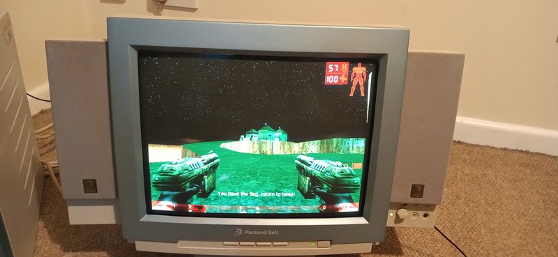

The speakers on the monitor sound fantastic! I'm surprised and I also noticed it installed SB emulation! I'm yet to try anything DOS related but it's nice to know it's there.
The ATI 7000 in it does a great job too (thanks again Vogons archives for the driver.) I might keep it original and leave the FX 5200 i ordered out of it as this card should be fine for anything 9x. It runs UT99 perfectly, i forgot how good CRT's look... silky smooth!
