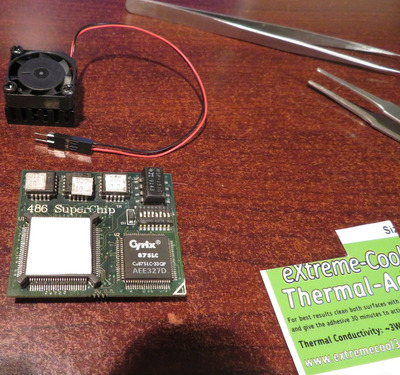

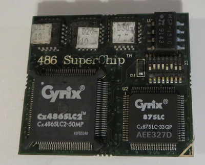

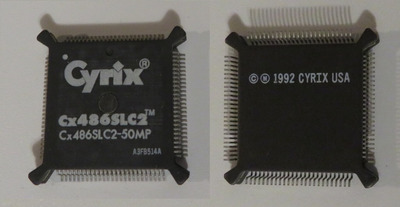

My Cyrix Sx486SLC2-50MP finally arrived. It took about 7 weeks, but looks to be original product.
76.97 KiB
1007 views

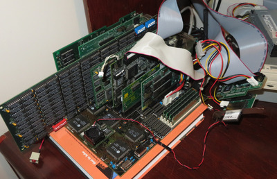

I desoldered the SXLC2-40 and soldered on the SLC2-50.
238.01 KiB
1007 views
The SLC2 is indeed default in 2x mode. I ran it at 66.6 MHz. With all of L1's cache region set as non-cacheable, chkcpu shows the speed as 61 MHz. With the cache region inhibited, e.g. with cyrix.exe -i1, chkcpu reports 33 MHz. Obviously, chkcpu is mistaken in both situations. Nonetheless, the SLC2-50 works fine at 66.6 MHz, but it needs active cooling. Without a heatsink and fan at 66 MHz, the system will hang up once the CPU reaches around 60 C. So I will need to figure out some kind of solution that isn't unsightly.

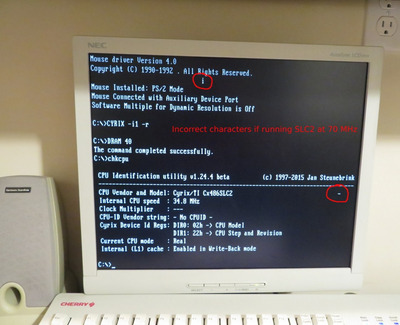

I then tried to run the SLC2-50 at 70 MHz, but I was noticing some characters on the screen that should not be there, so I assume 66.6 Mhz is a realistic maximum speed.
156.87 KiB
1007 views
The other configuration I wanted to try was an overclocked SLC33. If the SLC25 can only do 33 MHz reliably, then I figure the SLC33 can only do 40 MHz. This would give a 20 Mhz FSB compared to the SLC66's 16.7 MHz, but I doubt would make for a faster system. Now if the SLC33 could run at 45 or 50 MHz MHz, it would probably be faster overall than the SLC66. Unfortunately, the effort and risk required to solder/desolder these QFP chips is the limiting factor for me and I won't be experimenting further in this capacity. If I had another Evergreen 486 SuperChip, I'd be more willing to experiment further as I have three NOS SLC33 chips.

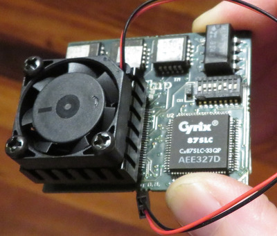

Reply 122 of 174, by feipoa

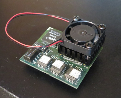

I decided to go with a 5-volt 25x25x7mm fan, a heatsink, and some thermal tape. I hope the thermal tape doesn't remove the Cyrix branding from the chip's surface if I need to remove it.
357.45 KiB
994 views
245.33 KiB
994 views
209.42 KiB
994 views

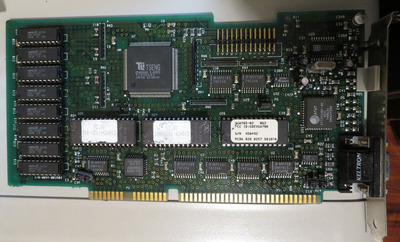

DiskMeter
5.0 MB/s DMA --------> 6.7 MB/s DMA
3333.3 KB/s ----------> 3397 KB/s, RANDOM
3375.5 KB/s ----------> 3448 KB/s, SEQUENTIAL
3382.6 KB/s ----------> 3911 KB/s, BUFFERED
Looks like the buffered result is the one which has the benefit.

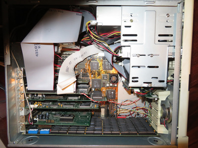

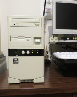

I was asked to show my 286 build for this Evergreen 486 SuperChip, so here's some photos.
Here's the case. I'm fairly fussy about matching all the shades of beige. I'm also particular about not leavaing the case badge location empty, so I modified the Cyrix 386-to-486 logo to make it a 286-to-486, then added the SLC2 component to it.

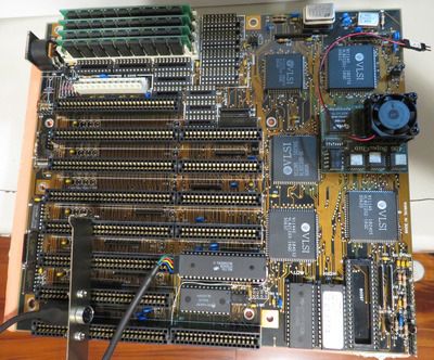

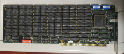

Reply 139 of 174, by feipoa

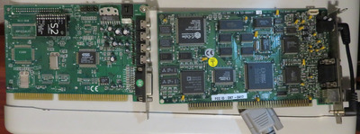

An image of the motherboard and the various expansion cards I'm using. The memory expansion card adds 3 MB, but as will be shown later, the speed in this 3 MB space is slower than the mainboard's memory. Adding 70 ns 256Kx1 DRAM doesn't help any compared to 120 ns. The RAMDAC on this ET4000AX card is pretty slick - crystal clear 800x600x15bit and x16bit. I've set the system to 15bit.
Although I'm using a PS/2 mouse on a modified keyboard controller, I decided to add an RS-232 card just in case I wanted to test some serial mice. I've also added the REEL Magic Maxima card, hoping to test some REEL Magic games and MPEG-1 decoding at some point in the future. It comes with a pass-through cable, which doesn't show any noticeable noise up to 800x600. At 1024x768, you start to see it. I add ethernet to all my systems for file convenience. I find the Etherlink III 3C509B works best on slower 286 and 386 class hardware.
