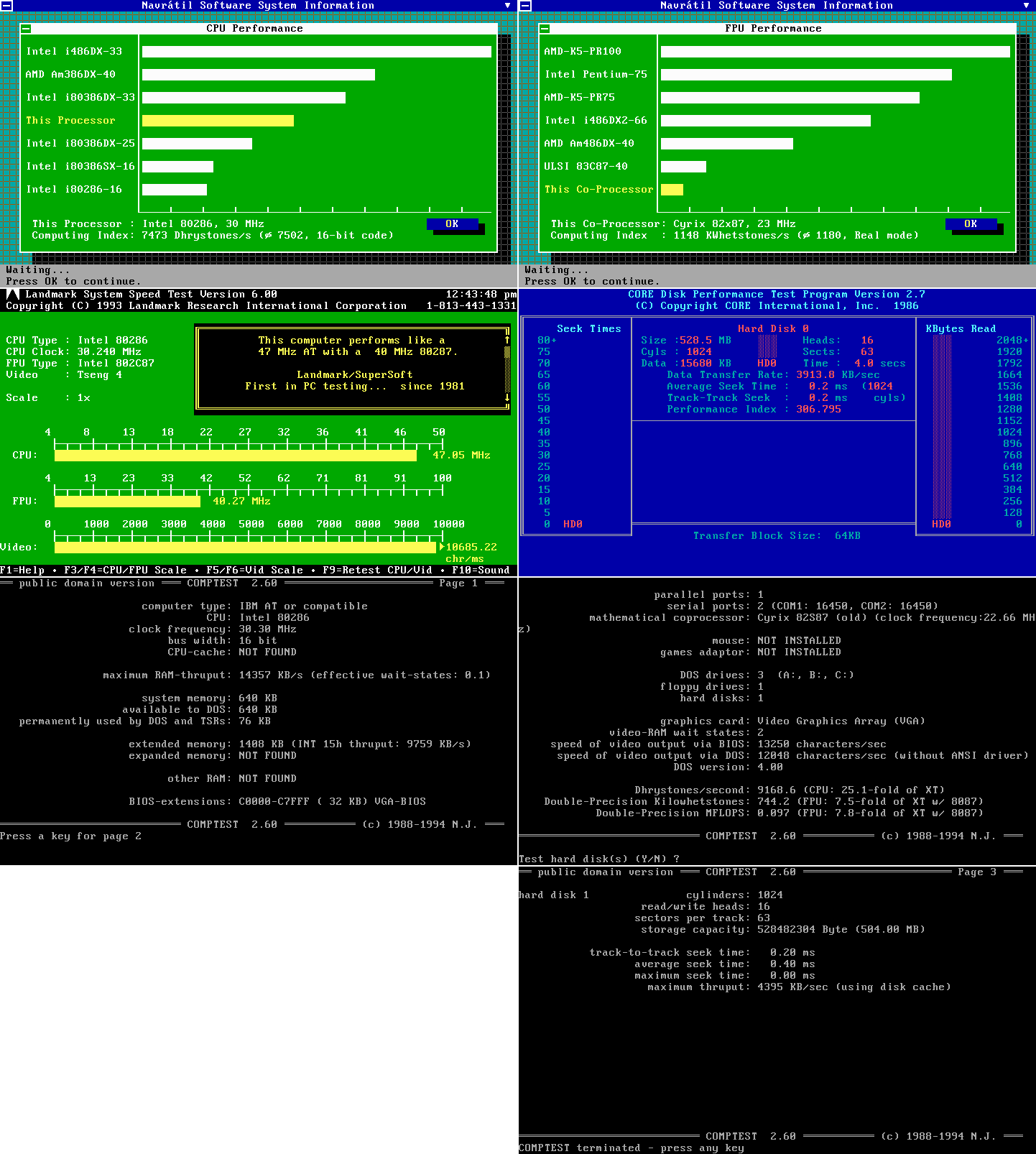

Reply 812 of 2436, by pshipkov
Posted a while ago about what was supposed to be the final chapter of peak 286 overclocking to 27.5MHz and 0 wait states + other performance improvements.
Link here.
But ever since then i felt that the VLSI-200 system can handle 30MHz at 0 wait-states.
Achieved it today while looking at some other issues with Feipoa.
Snowballed there somehow.
This was hard.
From the small set of highly-curated 1Mb 30-pin SIMM memory modules only 2 worked reliably. They use Hynix/VT branded chips.
The rest were almost there but always led to some instabilities in different situations.
Then had to curate the VRAM of the Diamond SpeedSTAR 24 video card (picture in the first post of this thread).
Originally it used 60ns Siemens chips, but at 0-ws (JP1 on the card) some graphics were corrupted or not displayed at all.
Once swapped with VT branded ones (did you notice the pattern ?) things started working again.
The usual stats - numbers are great.
Notice the ~4Mb/s IDE readings.
And some performance tests.
The same Dunson Electronics motherboard, same everything, just higher frequency.
benchmark results
Captured video showing the PC rig with full gear, Wolf3D, Superscape, Landmark, NSSI, Windows 3.0.
Will need to find 2 more of these Hynix/VT modules to max-out the RAM.
Other than that - satisfied with the outcome. Bar moved further up.
Feel confident enough to claim "fastest 286 PC".
It will require CPU upgrade module with 486 DLC chip to improve on these metrics.
Did that before. The outcome was less than ideal. Left potential improvements for later.
Currently watching this thread - some good signs there for interesting results down the line.

Initially the PC was equipped with Diamond SpeedSTAR24, but Micro Labs's Ultimate VGA/TrueColor BIOS from year 1998 offers additional optimizations that make their card perform better than any other ET4000AX one. Unfortunately the BIOS does not work on other cards, so one non-period correct change had to be made to the rig.
Micro Labs Ultimate VGA/TrueColor
24 fps in Wolf3D look great for a 286 machine.
