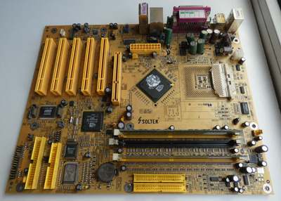

I don't usually pick very damaged stuff, unless it's something really interesting/unique. Well, couldn't take my eyes off this (former) beauty, so I got it for very cheap.
814.5 KiB
564 views
Fortunately the damage is very localized and vast areas of the board look brand new after the mandatory washing. Of course all 10 VRM caps (Sanyo and Nippon ChemiCon) are destroyed while the rest of generic junk are in perfect shape 😁.

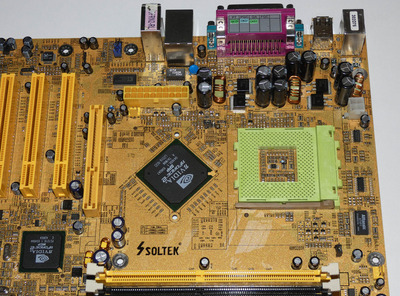

843.34 KiB
564 views

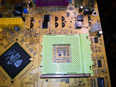

Most of the destroyed or missing parts are already sorted out and I will replace them tomorrow, but in the area between the CPU socket and the VRM caps there are three badly damaged SMD resistors. I've been able to determine the value of two of them, but the third is beyond any hope. I know it's not a very common board, but maybe someone here has it and can help me with a close-up of that area - I cannot thank you enough for that effort.
It seems that the "L" variant is much more common than this "RL", but from what I've seen the relevant area is identical.
Cheers!

The inductors (and the socket) will be transplanted from a dead GA-7N400 Pro2 and hopefully they'll work. VRM stage is quite similar (HIP6602+6301 for the Gigabyte, HIP6602+6302 for the Soltek, difference being due to the number of phases, 3 vs 2).
An extremely nice chap that sells a similar board on a popular auction site helped me today with very detailed photos of the area, and the resistor in question is marked 103 (10kohm). Before that, I tried to measure the biggest piece (it was split in three), and after much hassle I got a reading of around 77k, so without the photos I would have been far off the value, fitting a 100k in there.
Traces look very good so far, but the final verdict will be after I remove all the socket remains. So off to work I am 😀

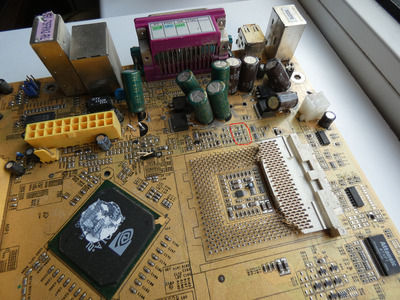

Reply 4 of 19, by bofh.fromhell
Somewhat OT.
But I'm guessing the inductors where pried of because they had copper visible on them.
And the rest of the damage is just the result of the crowbar or large pliers used.
If the board was bent at lot during this violation there's a chance the NB solder balls are cracked =/
If only the perpetrator knew that an undamaged board would be worth atleast 100x the metal value.

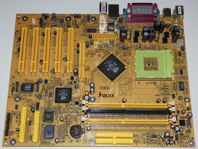

Looking good:
1.13 MiB
391 views
1.34 MiB
391 views
But unfortunately, dead as a doornail. No beeps, POST card only shows dashes. Tried multiple CPUs, various RAM sticks or even no RAM at all, hoped for a corrupted BIOS so tried two other versions that I could find on the net, nothing. Vcore is spot on, the other VRM below the AGP slot that had one coil smashed is outputting 1.5V, went all over the board with a magnifier and couldn't find any more damaged SMDs or anything out of the ordinary. I tried to keep my expectations low, due to the initial state of this board, but still it's tough to admit defeat. I guess I'll frame this and hang it on my wall 😀

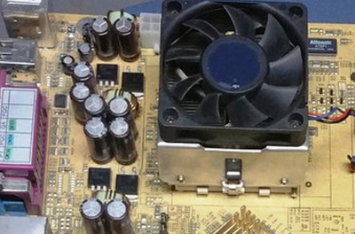

Is the CPU getting warm when you measure Vcore? If not maybe Vcore breaks down under load and the CPU is turned off.
I think there are 3 VRMs for the CPU. Do all of them work?
On some pictures on the net the right VRM inductor has only very few windings (about 4). and the magnetic core is larger.
64.94 KiB
361 views
If the VRM circuit is unable to compensate this difference and the core voltage doesn´t match the nominal value exactly, the board probably won´t start up.
Like in the cases where capacitors deviate to much from their nominal values and the system doesn´t start up also.

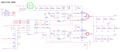

Reply 14 of 19, by quicknick
CPU is getting warm, heatsink gets really hot if I unplug the fan. I said earlier that Vcore is spot on, well actually it's about 30mV higher than nominal (tried with 1.5 and 1.6V CPUs).
Your reply motivated me to investigate further, so I checked the datasheets of HIP6301 and HIP6302 (the PWM controllers of the donor Gigabyte board and of the Soltek board. Both have their switching frequency set by a resistor, and on both boards this is 150kohm resulting in a frequency of 200kHz, therefore I assume the inductors should be roughly compatible. They are almost identical to the originals on the Soltek (3 wires in parallel, 5 turns, green core).
The other inductor that you mentioned, near the Aux 12V connector, is actually located before the VRM stage (circled with green on the schematic below), and it is pulled from the same position from the donor board. I have very limited knowledge of the inner workings of the VRM, but from what I know this inductor isn't as critical as those on the output (circled red...ish).
Now, studying the datasheet I found out they both have a PGOOD pin:
HIP6302 datasheet wrote:
Power good. This pin provides a logic-high signal when the microprocessor CORE voltage (VSEN pin) is within specified limits and Soft-Start has timed out.
Measured it, was very close to zero volts. At this point my expectations were sky-high, I thought I was onto something. Next logical step was to measure the VSEN pin:
Power good monitor input. Connect to the microprocessor CORE voltage.
To my surprise, VSEN voltage was around 1.36V (Vcore being around 1.63V). Again from the datasheet, voltage on VSEN should be within 10% of what is requested through the VID pins, else PGOOD goes low.
The gold paint on this motherboard makes next to impossible to follow a trace, so I didn't waste much time trying to figure out where the voltage was 'lost', and directly connected Vcore to VSEN via a 100ohm resistor. With this mod in place the VSEN rose to about 1.6V, well within the 10% window, yet the PGOOD remained low.
Having no explanation for this I tried to make sure it isn't a case of something else on the board keeping the PGOOD low, but soon another surprise - nothing is connected to the corresponding pad. I even desoldered the controller to check if there isn't a trace going "inwards" from the pad, and indeed there isn't one. The Soltek board doesn't make use of the PGOOD signal from the PWM controller. Still, this doesn't explain why the PGOOD remains low even with VSEN brought to (almost full) Vcore.
Finally, here's the schematic. Oh how I wish I had the Soltek one, but it seems impossible to find. Instead, here's the VRM stage of the MSI KT4V which uses the same chips as the Soltek (HIP6302 PWM controller, HIP6602 MOSFET driver), major difference being the input voltage (the MSI powers the CPU from the 5V rail whereas the Soltek uses 12V instead). Other than that, the MSI really use the PGOOD signal from the controller, and here's the shock for me - the presence of R53/R69, a divider that is consistent with the VSEN drop that I measured on the Soltek board. This baffled me, because it means the voltage on VSEN can never be within 10% of the programmed voltage, so at this point I think either there's a mistake in the datasheet or I'm reading it very wrong...
171.95 KiB
337 views

EDIT: I managed to find schematics for Soltek 65KV. Page 17 is the VRM and HIP chip. Cross on pins means they are not connected/used. Fault, pgood and rt have those crosses. In my mobo, the 555 timer circuit which blinks the suspend button is reseted by south bridge. Now it's not reseting it. I'll read that schematic more some other day, I'll go to sleep now. Heres a link to the schematic, I hope it's okay to post it here: https://www21.zippyshare.com/v/VAMqLvSl/file.html

Reply 17 of 19, by quicknick
Hi eebenz, and welcome to the forums!
No I haven't connected any LEDs to the board's headers, but I think it's a very good idea as it might provide some clues. Will look into it when I'll revisit the board, which is now stored in the "dead" box along with an equally deceased GA-7VTXH+. I feel that I spent a bit too much time on those, and need to focus on some other projects to clear my head.
Interesting fact that they did not use the PGOOD and FAULT pins, maybe the operation of the Vcore VRM is not monitored at all. Since you have the schematic, you should identify and measure all the minor rails and ensure they are in spec (I was surprised at their number on the MSI KT4V, and the schematic allowed me to fix a short between the +3v3 and the 3VDUAL rail, whatever that is).
And speaking of schematics, since I was unable to find one for any Soltek board but you managed for yours, could you please check if one for my board is available? Thank you.
