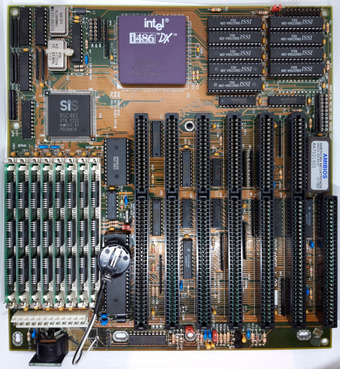

Hello everyone.
I have this 486 m/b that had suffered battery corrosion and found this forum as the exact same m/b was mentioned and shown by Skyscraper a couple of years ago. Mine has less battery damage so I'm hoping it's ok. So far the graphic card it came with seems to be dead so although with power attached (and a replacement CMOS batt with diode) the keyboard lights flash and the CPU gets toasty warm, I am unable to get any video as I currently don't have another ISA VGA card. Oddly the speaker doesn't seem to beep either, so that's probably not a good sign.

I'm affraid the only info you can have is the one printed on the silkscreen ... But from what I can see it should be sufficient.
The battery damage on yours is actually worse in my opinion because compared to his board where the damage remained located around the battery, your board has damage on every ISA slots. Even traces between the ISA slots are impacted ...
If you want to go through the journey of fixing it, I think you'd need to take off the ISA slots to check each damaged trace and also buy a POST card for testing.

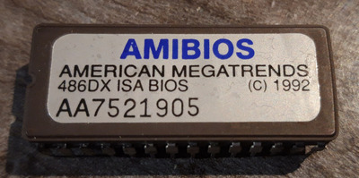

Hello, thanks. I thought the green corrosion on the ISA slots may be due to a damp storage environment. The BIOS socket was also a bit green, but I was able to remove the chip and read it (and put the contents onto a newer EPROM with clean pins). I'll attach it. I've deoxit'ed a lot and also checked connections around the battery and, along that side and also of the socketed chips - I also removed a few resistors to check under and around them. I couldn't find any broken traces (but who knows). A POST card is on its way to me. I'll do better pics.
zip of BIOS attached (which I also couldn't find anywhere online to verify, but it looks ok as far as I can tell). This is the detail on the chip:

The bios looks fine by me. These things rarely die as far as I know (I've had some that died but these were eeproms. One was simply unreadable and the other broke after I tried to write to it)

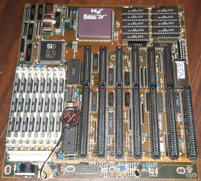

If you pay attention to the traces in the red areas, they've been corroded.
1.92 MiB
467 views
(even between the ISA slots) The green corrosion is usually caused by these batteries. I don't think I've ever seen any board with poor storage condition having their ISA slots that rusted that way (And I've had boards that had mud on them before I cleaned them ^^)

You're probably right about the green. Odd that it seems to migrate to the tops of the contacts. I don't think it's going to be worth the time to remove every ISA slot, everything else in the red areas and maybe more. As an aside: by far the cleanest ISA slot with hardly any green is the one closest to the battery.
I have a POST card and a VGA card on the way to me, it won't hurt to try those out.

This pic is better, including original BIOS chip.
