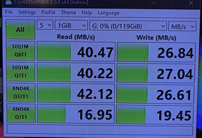

M.2 NVMe working on old school regular pci
First post, by Sphere478
It’s rather underwelming. But it’s working.

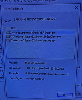

Benchmarks that I was able to look up show this M.2 doing around 100mb/sec
I suspect the bridge chip may be to blame
(Not booted from, but just recognized in windows and benchmarked I’ll get to that later if it turns out that sata isn’t faster option.)

Reply 2 of 38, by megatron-uk
In my P4 retro Linux box (the oldest Linux box that I run which has ISA slots and does my 5.25" disk copying) I have a Promise SATA 300 TX2plus PCI card (it's an IBASE MB800 industrial motherboard - Intel 845 chipset, so only UDMA IDE as standard).
I have a basic 'Patriot Blast' 120GB SSD hanging off it, for the OS. Excluding overheads, it runs at pretty much the full bandwidth of the PCI bus:
sudo hdparm -i -t /dev/sdb
/dev/sdb:
Model=Patriot Blast, FwRev=SAFM12.0, SerialNo=FEB4075B090803069349
Config={ Fixed }
RawCHS=16383/16/63, TrkSize=0, SectSize=0, ECCbytes=0
BuffType=unknown, BuffSize=unknown, MaxMultSect=16, MultSect=16
CurCHS=16383/16/63, CurSects=16514064, LBA=yes, LBAsects=234441648
IORDY=on/off, tPIO={min:120,w/IORDY:120}, tDMA={min:120,rec:120}
PIO modes: pio0 pio3 pio4
DMA modes: mdma0 mdma1 mdma2
UDMA modes: udma0 udma1 udma2 udma3 udma4 udma5 *udma6
AdvancedPM=yes: unknown setting WriteCache=enabled
Drive conforms to: Unspecified: ATA/ATAPI-3,4,5,6,7
* signifies the current active mode
Timing buffered disk reads: 334 MB in 3.00 seconds = 111.29 MB/sec
That's only ~20MB/s less than the theoretical peak PCI transfer rate. I suspect that's near as damnit the best possible result for an SSD hanging off 32bit/33MHz PCI.

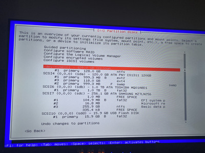

Reply 3 of 38, by Sphere478
I have a promise tx4 but windows fails boot whenever a hard drive is plugged into it on this computer so was unable to test

4 lanes of PCI Express 1.0/1.1 is 4x250MB/s=1Gigabyte per second ! I dare hope that's fast enough for an Fx-60 . 😉 I don't think you will find any NVME drives with 16 lanes (except maybe some specialized industrial ones ) as that would be overkill in modern systems and I doubt controller manufacturers would see much of an interest in optimizing for machines that are over 10 years old . Even the Intel P45 chipset that is going on its 13th birthday did PCI Express 2.0 . That being said, I remember manufacturers such as OCZ selling full size PCI Express SSD/controller combo cards that did support more than 4 lanes of PCI Express bandwidth . This is an x8 PCIEX 2.0 example : https://www.newegg.ca/ocz-revodrive-350-serie … N82E16820228113 . Not sure about modern OS support, if that is a concern .
To boot off of an NVME device, you need BIOS/UEFI support for it. There are ways around this using a bootloader on a bootable USB drive . See here for a slightly dated example example : https://web.archive.org/web/20190324115923/ht … t-se-mainboard/ and this for something more recent https://www.hamishmb.com/blog/booting-nvme-older-pc-refind/
m.2 to PCI Express adapters that are keyed for NVME devices are passive . NVME SSDs are electrically PCI Express and only require physical adaptation .
According to WIKIPedia, unofficial NVME drivers for Windows XP do exist (whatever that means) which is a bit surprising, considering NVME appeared when XP was dead/dying . I honestly doubt there ever were enough people running Windows 2K or earlier on PCI Express hardware for hardware manufacturers or Microsoft to care . Windows 7 supports NVME natively through updates . Windows 8.1 and up support it natively . There exist third party drivers from some hardware manufacturers, but TBH I have only had strange issue with some Windows 10 updates when using one of those third party (manufacturer) drivers, so I reverted to native OS drivers .
