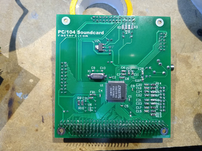

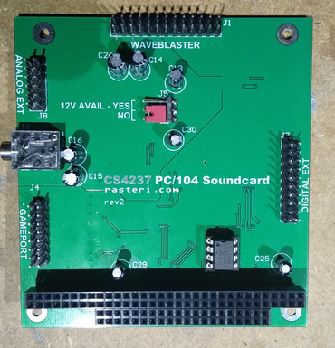

I wanted to build a mini DOS gaming PC (which has been discussed here : 486 MS-DOS gaming PC, this was a fun youtube video but short.) and frustrated by the cost and lack of availability of PC/104 soundcards, I decided to make my own.
The original revision had a few issues (incorrect gameport pinout, lack of EEPROM, +12v power requirement) but this revision works much better so I decided to release it.
852.86 KiB
6961 views
1.8 MiB
6961 views
It's based on the Crystal/Cirrus CS4237B, like the Orpheus. Unlike the Orpheus it's only designed to give very basic audio functionality and isn't audiophile grade by any means. The power supply filtering is garbage, there's no proper OPL or intelligent mode MPU, and the analog section is unbuffered with an iffy grounding scheme. The BOM could use some optimisation too (I have both 0603 and 1206 0.1uF caps for some reason). It does at least have a waveblaster port (which I've paired with a Dreamblaster S2 for my gaming PC).
Despite all this it runs all the games I want to run with acceptable levels of noise/hum/etc. It serves my use-case perfectly and I imagine other people will find it useful too.
Anyway, I've attached a zip file containing PCB gerbers, part list, schematics, and a BIN file to program to the required EEPROM. You'll likely need an EEPROM burner, although I believe there's a way to program the EEPROM on-card.
If you wanna build one I recommend getting PC104 connectors from aliexpress and CS4237s from utsource, everywhere else was more expensive.
PCB source files are in Altium Circuitmaker's cloud thingie - https://workspace.circuitmaker.com/Projects/D … 104-soundcard-3

Presently the MFBW1V3216-000-R mentioned in the BOM is unavailable. As my electronics knowledge is kind of lowish, I'd really appreciate if someoune coould suggest an available replacement, even better a direct mouser or digikey link.
Reply 14 of 25, by MJay99
raerek wrote on 2022-11-04, 05:28:
I had a quick look into the BOM and the website also, but didn't see that product number (maybe I'm missing something there). It seems to be a ferrite bead, though - the only FB I am seeing in the BOM is a 600MHz one (BLM31PG601SN1L), which is unavailable on mouser also, but with a similar one still being available: https://www.mouser.de/ProductDetail/Murata-El … /BLM31PG601SH1L
Reply 15 of 25, by raerek
MJay99 wrote on 2022-11-04, 10:21:
Thank you for the answer, and regarding the product number, yes, my bad, I was looking at a slightly modified BOM, as the original only says "Ferrite Bead, I dunno the value". In the modified one I have the MFBW1V3216-000-R suggested for FB1.
MJay99, where have you seen the BLM31PG601SN1L ? I am simply unable to find it in this This time I am missing something I guess:)
Reply 16 of 25, by MJay99
raerek wrote on 2022-11-04, 16:51:
I can see it e.g. on the bottom of the project's website here: https://circuitmaker.com/Projects/Details/ras … 104-soundcard-3
I also checked the link again I posted before - seems it's not working anymore without the session I had before. You can just search for BLM31PG601SH1L on Mouser and it should show up.
It's also not a most critical part - it's recommended to put a ferrite bead in the datasheet, to suppress possible interference, but there's surely not gonna be magic smoke in case there'd just be a zero ohm R (e.g. for testing).
Reply 18 of 25, by rasteri
Yeah the datasheet just says "ferrite bead", I didn't do any of the calculations or testing to determine what the best value should be. To be honest I doubt it'll make much difference if you just short the pads with some solder...
Reply 19 of 25, by raerek
rasteri wrote on 2022-11-05, 11:47:
😀 You know I am beginning to learn that, but you see I am so firmly undereducated in the field of elecronincs, that it was kind of non-obvious.
