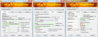

Reply 8 of 17, by 2mg
Dege wrote on 2021-03-02, 19:13:
There is the new 'fake' option for fullscreen rendering in 2.73, plz try that.
251.53 KiB
1595 views
So with these I'm able to get the fullscreen borderless with smooth frames, but still the mouse falls thru bottom and right sides of the screen.
I've tried checking if not using "Scaling mode" combined with "Fullscreen size" to get the small 640x480 window, it keeps the game's cursor inside the window, but not the windows cursor.
Am I doing something wrong?
Reply 10 of 17, by Dege
2mg wrote on 2021-03-18, 22:04:
Yes, you're still running the game in forced windowed mode, so attribute Fake has no effect at all, it's a fullscreen attribute.
Run the game in fullscreen mode as you'd regularly do, enable attrbute Fake and don't care about windowed attributes.
Reply 11 of 17, by 2mg
Dege wrote on 2021-03-19, 11:32:
Nice, it works and is very smooth! Thanks!
