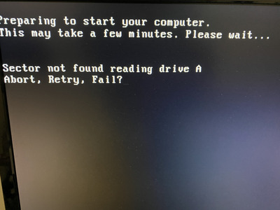

Hi, I bought a Futro S300 thin client and it arrived today.
It has no built-in floppy, no CD-Rom, but supports USB-CDROM or USB thumb drive boot.
I wanted to install DOS6.22 and Win98 dual boot. However, I encountered another problem when I wanted to install them.
My internal HDD is a Sandisk 32GB CF card inserted into the onboard CF slot, and in Bios, it was successfully recognized as 29GB IDE device. In bios I set the IDE mode to be UDMA33 (I dunno if this will affect anything or not, it could be set to legacy PIO mode).
I made two bootable USB thumb drives by burning the bootable image from allbootdisks (https://www.allbootdisks.com/download/iso.html) to the 2 thumb drives by UltraISO burning tool. The DOS6.22 doesn't work at all, when boot sequence was selected as USB-IDE first (my thumbdrive's name) it got into a dead loop trying to boot from usb but failed etc...

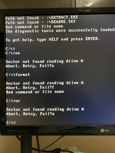

When I tried to boot my WIn98SE bootable thumbdrive, it booted into the dos prompt and I could do FDISK for the 32GB internal CF card, but for all other command it always prompts (see screenshots in attachments):
Sector not found reading Drive A
Abort, Retry, Fail?
I don't even have a floppy drive (none usb floppy was attached at all)
and this error occurred periodically and I could not even type a full command, it interrupts in the middle of typing a command.
There's another headache, when attached, the USB thumb drive will always be recognized as C:, and the internal CF card on which I want to install OSes is recognized as D: ... therefore I could not set active the D:....
How can I solve this, and how can I install DOS6.22 using thumbdrive?

This is just my opinion, but I don't see the point in DOS 6.22 . It will limit you to a 2GB partition size and there is nothing it can dos that Windows 98SE's DOS 7.1 cannot do just as well .
My approach would be to connect the CF card via a USB adapter to a modern PC running a Windows 98 SE virtual machine , format, partition and make bootable the CF card through the Windows 98 SE VM, copy the win98 directory from the installation CD to the CF card and then boot the Futro S300 off of the CF card and install Windows SE by running setup.exe from the win98 directory .

Thanks for everybody's help. Just a follow-up. I purchased a Lenovo USB CD drive, some CD-RW's and burned the booting disks, but to my disappointment, it doesn't boot, I tried the disk on my desktop (much modern one dated back to 2016) the CD could boot... I suspect there was a compatibility issue with the drive?
I have to shell out another $20 to buy a CF card reader (which I don't have at all) and try to install the OSes via virtual box... hope it will work, but who knows.
The thin client just cost $35, but to install an OS onto it, the "investments" are far more expensive than the machine itself...Lol

I figured out why external CD drive could not boot it, it might have something to do with the current/power that the USB port could provide: when loaded with boot CD, this guy tried hard to spin it up but failed and tried it again and again, this might be due to the degradation of the USB port power supply? Or The power is ok but there’s a driver issue, I mean the bios was not able to fully drive this External CD drive...
I brought a CF card reader and successfully installed Dos6.22,win3.1 and win98 via virtualbox raw disk access(And there comes a minor USB driver problem of my USB keyboard and mouse, I ordered the PS2-USB adapter which is still on the way...)

Well, being able to boot a external CDROM is both a hardware requirement (the BIOS must allow USB/firewire to act as a boot source) and software requirement (the software you are booting must have provisions to allow boot from there) - so even if the hardware you have can boot from CDROM, the chances of it booting Windows 95/98 off a USB CDROM drive is practically nil....and eeeh, you might need a Y-cable. Most legacy USB external CDROM drives that I know of either uses its own power brick/wall wart to drive it, or uses a Y-cable to grab power from another port. Don't forget that with normal USB it's only 5v, 500 miliamps max per port, and 2.5 Watts is not quite enough to power the USB->PATA bridge, the PATA drive electronics and the motor used to drive the optical media.
