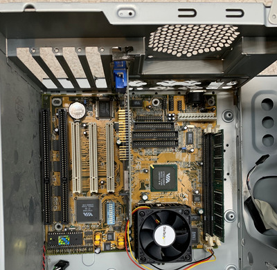

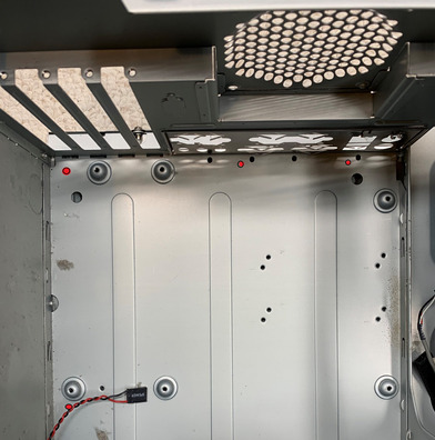

Has anyone performed "realignment" surgery on a Micro ATX case so that it fits a baby AT motherboard?
I got plenty of old Micro ATX cases, and it seems like I just need to
  1. mash down a few stands
  2. fit in a few new ones
  3. put in a 5th slot for an AGP card.
Has anyone else tried this?

Reply 1 of 11, by squelch41
my 486 baby-AT board is in a micro-atx case - just bought a blank io shield to cut a hole for keyboard connector and cut holes to mount serial ports in.
Drilled holes in the right places for standoffs in the motherboard try.
I had 3 cards and then used the last slot to mount a CF-IDE backplate so didnt need to cut out an extra panel.
Works well

Mine is a 5 slot baby AT mobo, so the AGP is the only slot facing a wall, but the AGP slot comes out pretty close to the existing serial port opening, so I'm going to see what I can do with a Dremel when I get a chance. I'm also going to get a 6-32 tap to see what I can do for posts.
I find lots of micro ATX cases in good shape and some full size ATX cases which I need for the full size ATX boards, but the baby AT cases don't show up very often any more.
