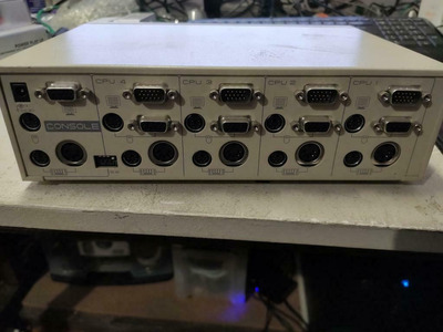

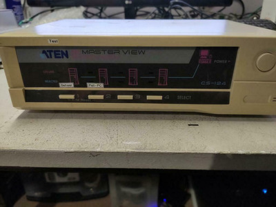

Reply 3 of 8, by scroeffie
thinking of this one and than find something else for audio

Reply 7 of 8, by scroeffie
i bought the aten kvm switch on the pics above ,but not shure what kind of cables i need to buy ?
i have a 386 serial mouse din keyboard ,p1 serial mouse din keyboard ,and a p3 ps2 mouse and ps2 keyboard
any one can help me
thanks
Reply 8 of 8, by chinny22
just standard extension cables should be fine.
You can also buy KVM cables with 2 PS2 cables are moulded into the VGA cable so you don't have 3 separate cables going between each PC and the KVM.
Perfect for the P3
KVM cables supporting serial are harder to find, maybe still worth the PS2 style for vga and have a din to PS2 adapter for keyboard, then you only need to run 1 extra cable for the serial mouse
