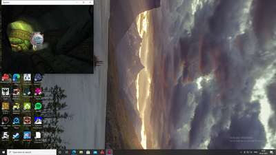

Reply 2 of 4, by BEEN_Nath_58
I decided to launch from the desktop and this thing occurs again. The mouse cursor is frozen in the centre of the screen, when I Alt+Enter it changes from windowed to fullscreen but then reverts back immediately.
download/file.php?mode=view&id=103299
As you see in the picture, the window is in the top-left of the screen.

Reply 4 of 4, by Dege
Do you play this game with dgVoodoo ddraw.dll and d3dimm.dll copied into the game folder or natively?
For me, natively the game doesn't even start up. With dgVoodoo the video playback is missing, only blank screen (not clear why, but nothing is rendered into the dd surfaces from the game side).
Aside from that, Glide works as expected and I can toggle fullscreen/windowed by Alt-Entering.
