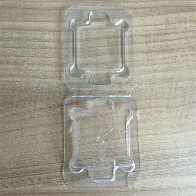

I have quite a lot of CPUs in this size but I can't find anything that is cheap like the 775 cases, sealed tight to prevent damage and transparent to check it without opening it.
I've seen a few other types but most of those are not sealed or they are super expensive.
100 pcs of 775 clamshells cost ~$15, that's reasonable and that's what I'm looking for.
How do you store the bigger CPUs in your collection?
I'm afraid to ask about slot 1/A CPUs...
    343.5 KiB
    572 views
    775 case

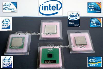

Well that's too bad. The american solution is quite good but it costs $90/100 pcs + shipping.
The russian version is open and only holds 6 CPUs.
    315.78 KiB
    539 views
    370 case

I use those clam shells. They work well for all different size CPU's (up to Pentium Pro) and provide good pin protection during storage. At a little under a dollar a piece with the ESD foam included (ebay), it is reasonable. I'm sure they can be found on Aliexpress or something for much cheaper, but I haven't looked. As far as Slot 1 / Slot A CPU's, I just put them in an ESD safe bag and put them in the box with the rest of my clamshell protected CPU's.

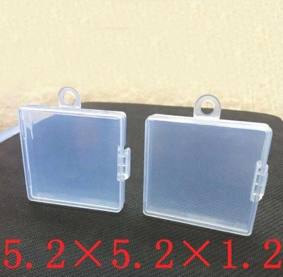

Thanks guys but these are open trays and I'm looking for clamshell types to protect against dust as well.
This is the cheapest I found so far, ¢32 a piece on Aliexpress, jewelry storage boxes.
Still a lot of money because you have to buy 500 pcs + shipping.
    44 KiB
    353 views

I recognize that ebay listing image!
I actually bought 200 of those holders, at the time it was more like 0.75 per unit. I can say, they work perfectly for any cpu up to those large xeon chips. part of the reason they cost so much; they have to cut that anti-static foam by hand and insert it into each clamshell. then shipping is a large cost because the box is large and light.
yea, its still a bit high on the price considering, but the solution was 100% effective.

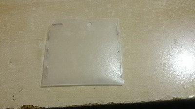

Found a cost-effective solution that fits my criteria:
- transparent clam-type
- protects against pin damage
- fits all s370 CPUs
- super cheap
- easy to make
Overall cost of a single homemade clamshell for s370 size CPUs (with safety pin): ¢10
Overall cost of a single homemade clamshell for s370 size CPUs (without safety pin): ¢6
Tested on IBM, Intel, AMD CPUs of this size. Dropped a Celeron 433 from a height of 50 cm multiple times(~20"), no damage.
The safety pin is not mandatory, the hard, flexible plastic holds the CPU in place.
No ESD protection but this can be made using ESD proof material as well.
Other sizes are also possible, even slot1.
    434.77 KiB
    224 views
    Standard transparent disposable PP food box lid, $30/500 pcs, size 13x18 cm (5x7”)
    411.4 KiB
    224 views
    Cut the edges off
    406.72 KiB
    224 views
    Fold it in half
    1.83 MiB
    224 views
    Staple it 8 centimeters (3.15”) apart, cut the rest off, staple one side on top
    1.66 MiB
    224 views
    Use a hole puncher to make a hole on top (optional)

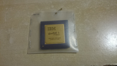

Cheap protection for s370-sized CPUs.
    1.79 MiB
    221 views
    Use a tiny safety pin to secure the CPU ($4/100 pcs) (optional)

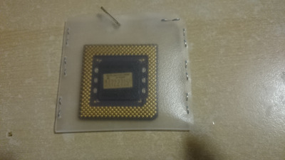

    1.85 MiB
    221 views
    pin side

no offense, but then you could have also just taken the antistatic shielding bag route that I'm currently using ^^
that would have been just as cheap, no work involved, and ESD safe.
Reply 17 of 22, by Miphee
It's similar but not the same, the PP lid is very strong and prevents physical damage.
The ESD bag is too soft and doesn't offer clam-like protection, it was important to me.
Essentially it's the same as your ESD bag but it's size fits the CPU perfectly so it doesn't move around at all.
