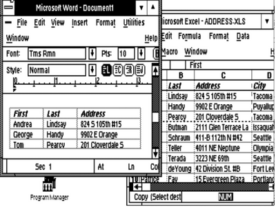

* Microsoft Word for Windows v1.1a (tested)
The first version of Microsoft Word for Windows, capable of reading/editing/writing (early) .doc files.
* Microsoft Excel for Windows v2.1d (tested)
The first version of Microsoft Excel for Windows, capable of reading/editing/writing (early) .xls files

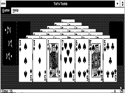

* Tut's Tomb for Windows (tested)
A windows card game using the same card graphics as solitaire.

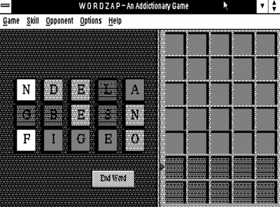

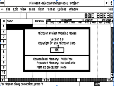

Added some screenshots for fun - these were taken from 86box configured with the BIOS and CPU from the sharp
One of which is a table copy/paste from Excel into Word - pretty cool for real mode!

    Excel and Word in RM

* Microsoft Project [Working Model] 1.0

* Wordzap
* Tuts Tomb

I found tut's tomb and tested it, works fine in real-mode on 8086, and added it to the list....
Can't find a suitable copy of WordZap though, maybe you can PM me a link...
I did find the Microsoft Project "working model", but it did'nt work, it requires a 286+ cpu... 🙁
